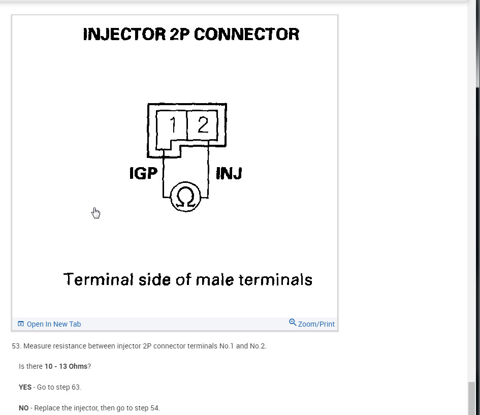

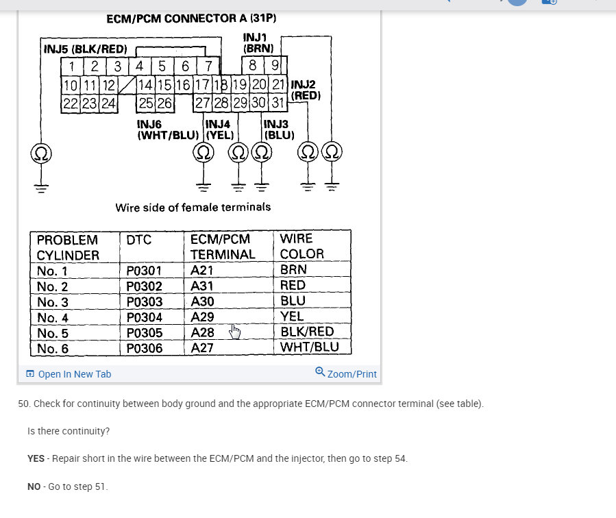

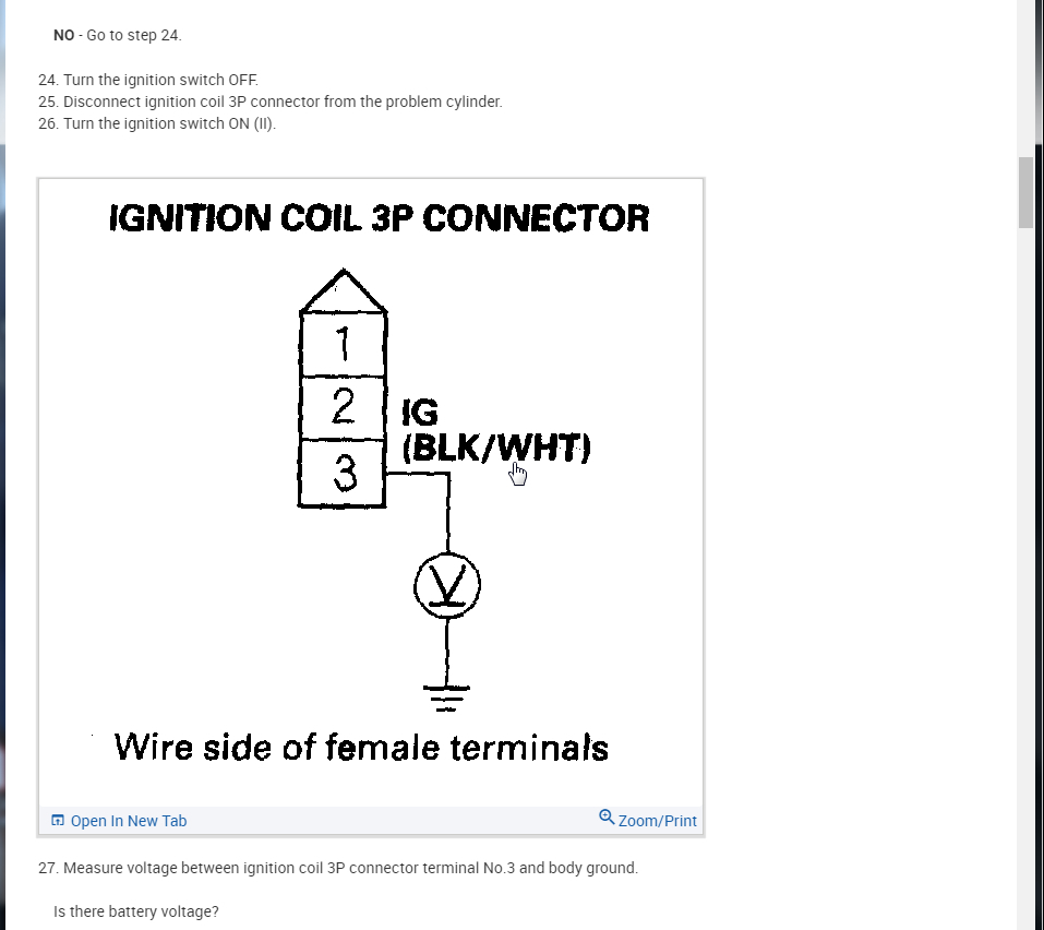

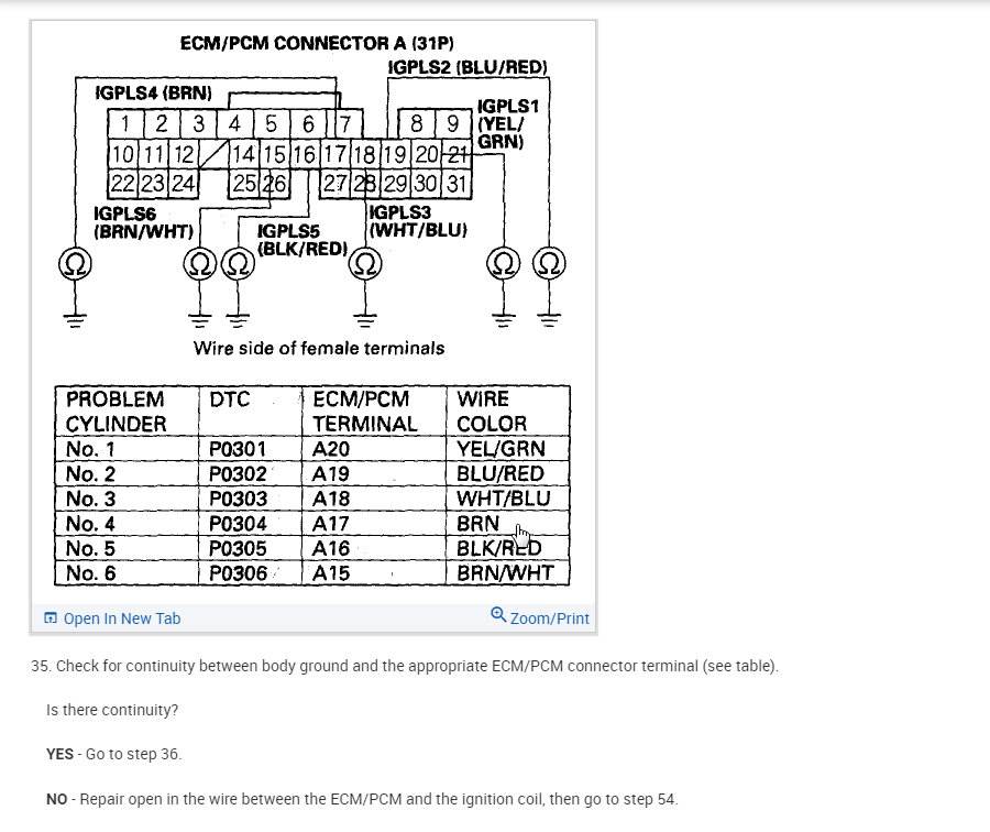

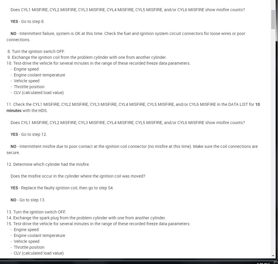

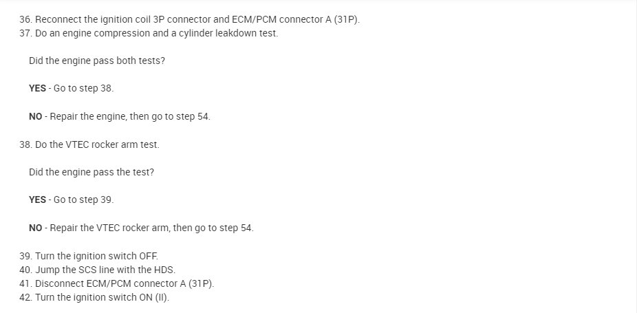

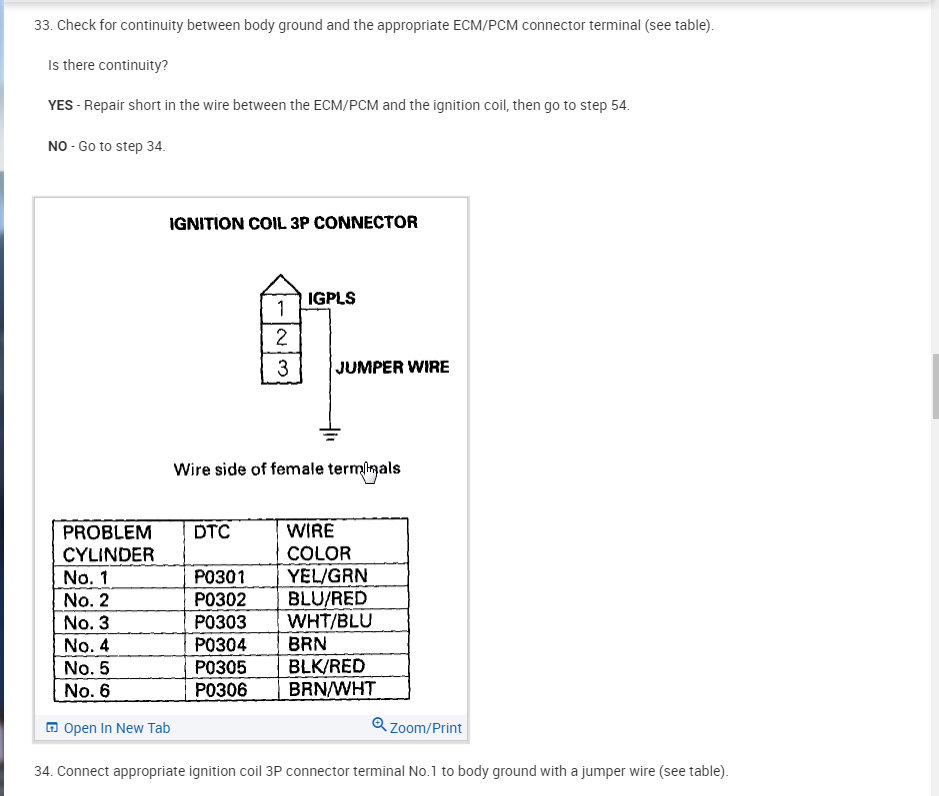

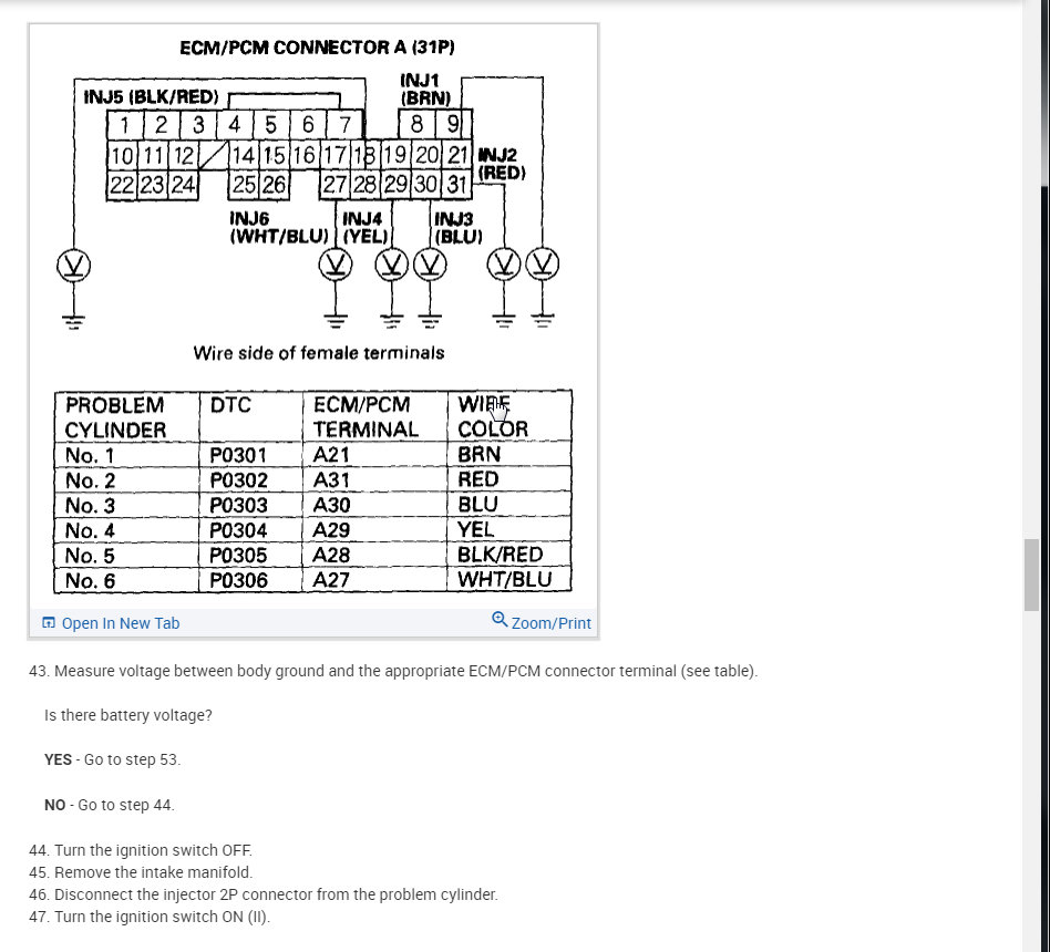

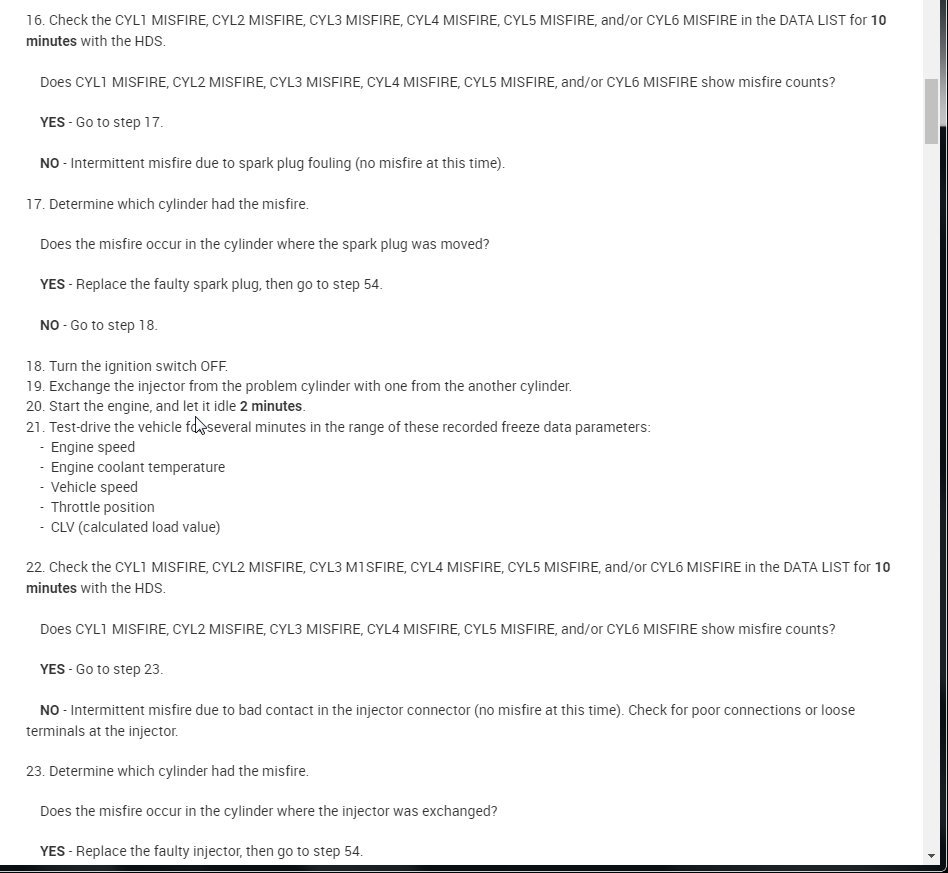

Can I get help please? I had a cylinder 6 misfire code. Shakes somewhat at stop. I replaced that injector and all the spark plugs. Code still came up, so I replaced all injectors and all coils. And it seems word? I am lost. And now more cylinder misfires come up. What else could it be? Oh yeah and when I unplug cylinder 6 coil, nothing happens, the engine does not shake more. But I checked the spark on the coil and it is there. I have checked compression also and it s at 120 like the one next to it. Help please
Apr 5, 2020 at 9:43 AM
I have a few thoughts. First, your compression is a bit low. The minimum spec is 135 PSI so we may need to come back to the this.

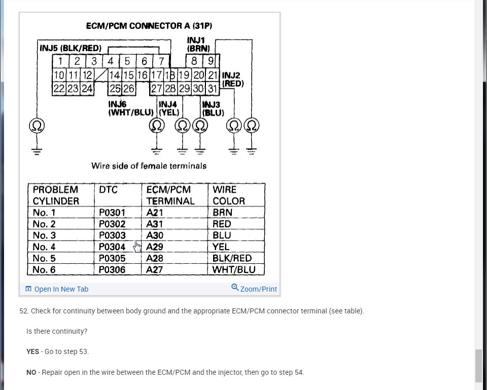

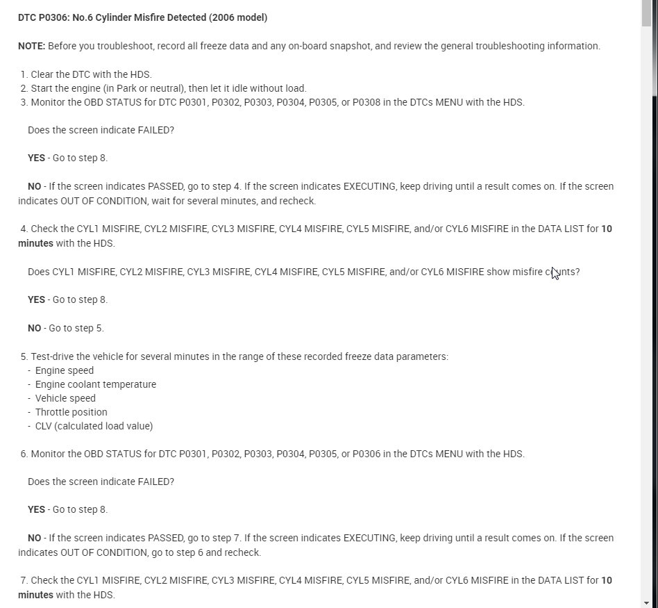

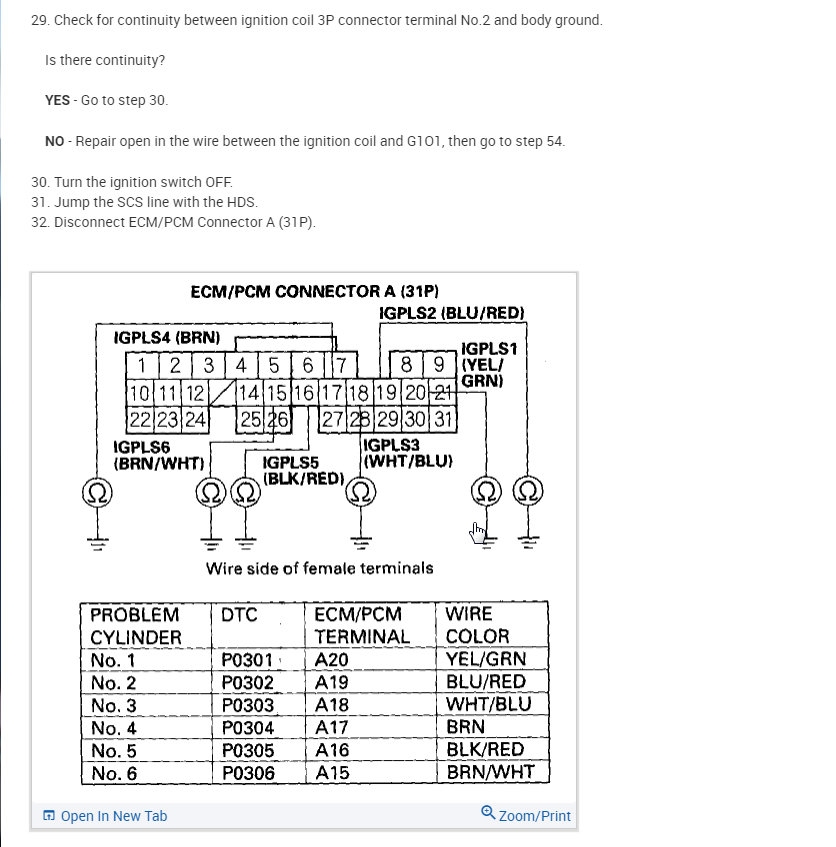

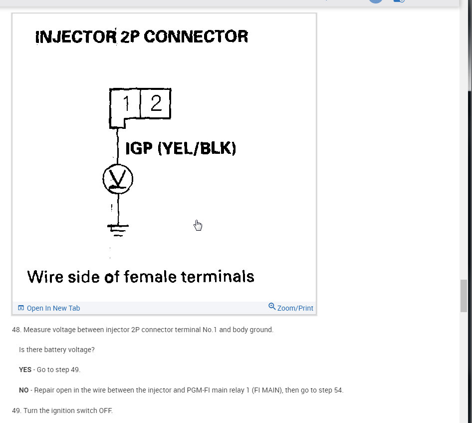

However, do you have access to a scan tool where you monitor live data? I want to see what the short term fuel trims are saying to see if the o2 sensors are saying it is rich or lean?

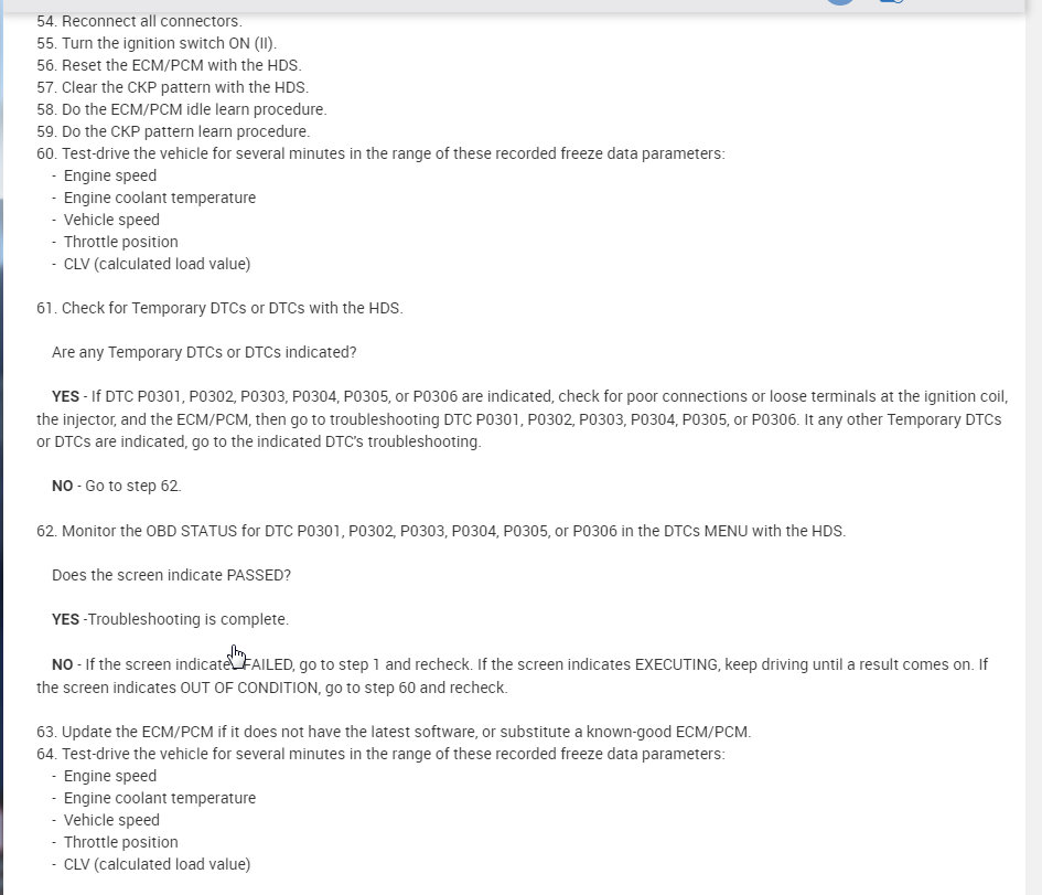

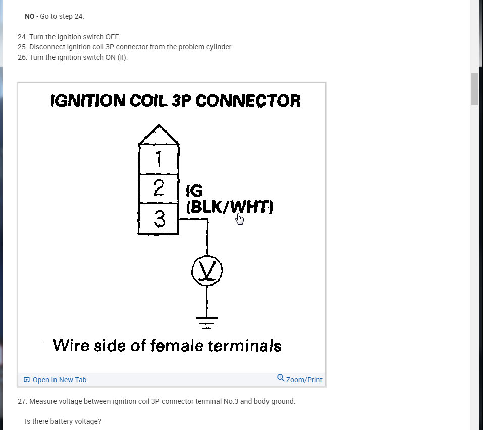

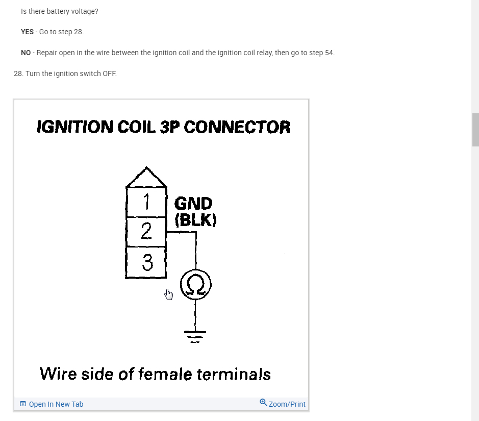

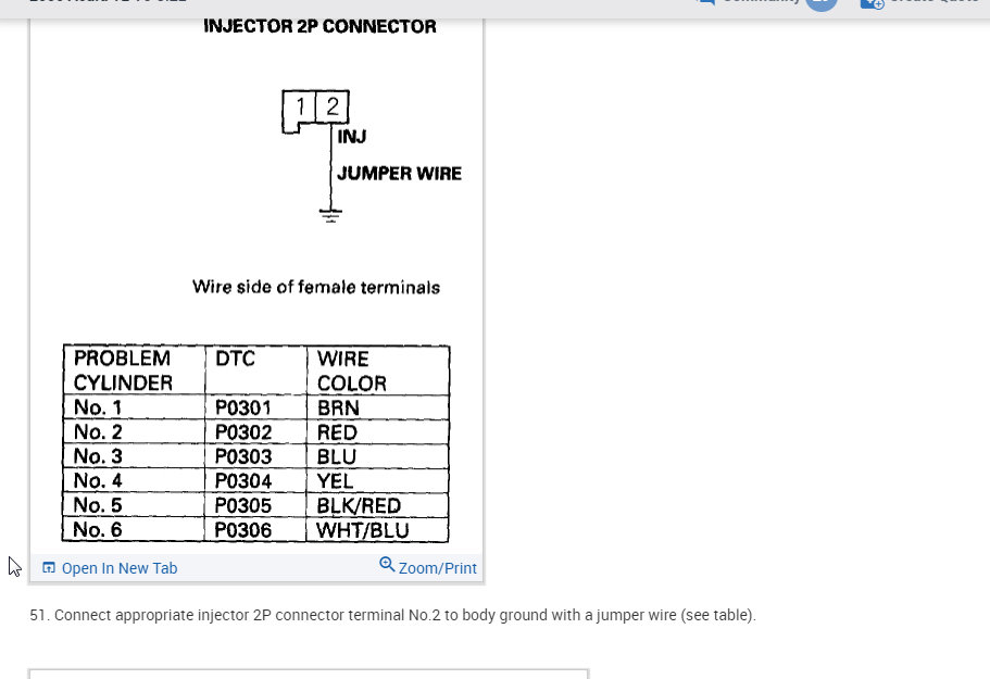

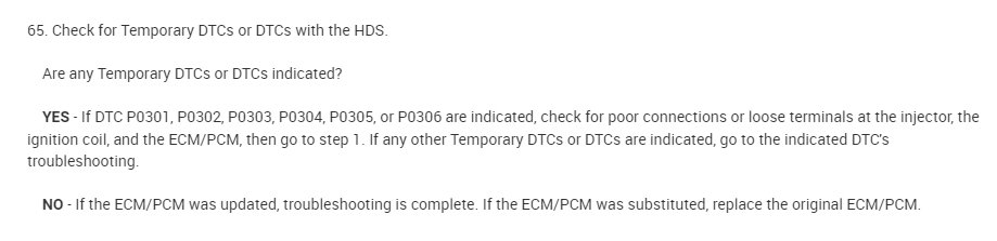

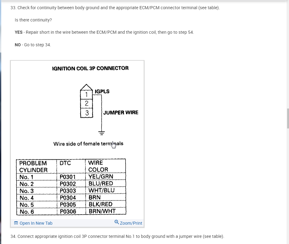

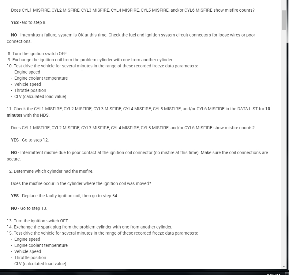

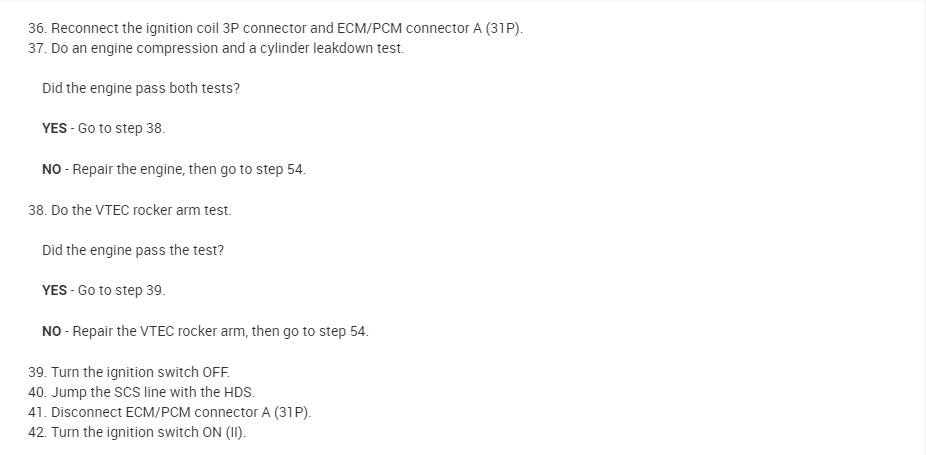

I then attached the lengthy testing from Acura on this code. They do a very good job covering what is left. I would suggest running through this because I don't think the compression is the issue at this point.
Basically the wiring and control module are the main issues we need to rule out at this point. Let me know if you have questions and we can go from there. Thanks
