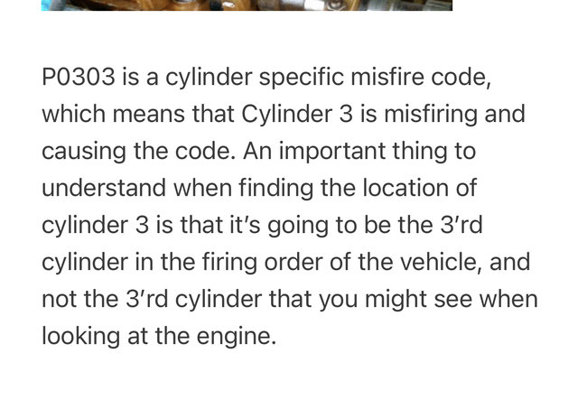

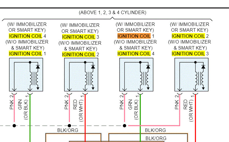

Saw this, is this possible? Meaning firing order of 1, 3, 4, 2 and so it could be cylinder number 4 that is bad?
Nov 23, 2021 at 7:53 AM
  • 110,248 POSTS
Interesting one. I ran through the manuals and found nothing as far as firing order or cylinder identification. I would have thought, like you, this is crazy. LOL
So, after finding nothing, I went to the powertrain management schematics. Believe it or not, the ignition coils are at different locations based on if the vehicle has a smart key or not. Ugh!!! I can't believe it either.
I attached what I found in the schematic. In theory, cylinders 1-4 are as we know them to be. However, the coil can be located in different cylinders. (I don't even know if that makes sense to me) LOL
Take a look at the schematic and let me know your thoughts. Also, I went with a 2.4L 4 cylinder. There is a 2.0 turbo. If I got the wrong one, let me know.
Nov 23, 2021 at 12:50 PM
DIVIDES
  • 903 POSTS
So, my misfire on 3 would be ignition coil 2 counting from left. With a smart immobilizer they mean a fob I am guessing.

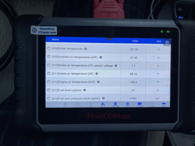

Yes, to your question about the FOB. If the misfire didn't move, it could be a few things such as lower compression in that cylinder, a faulty fuel injector, or an issue with the MAP.
The intake air temperature sensor is part of the MAP. If you have a live data scan tool, see if the reading from it seems possible. Also, let me know what the short-term fuel trims are.

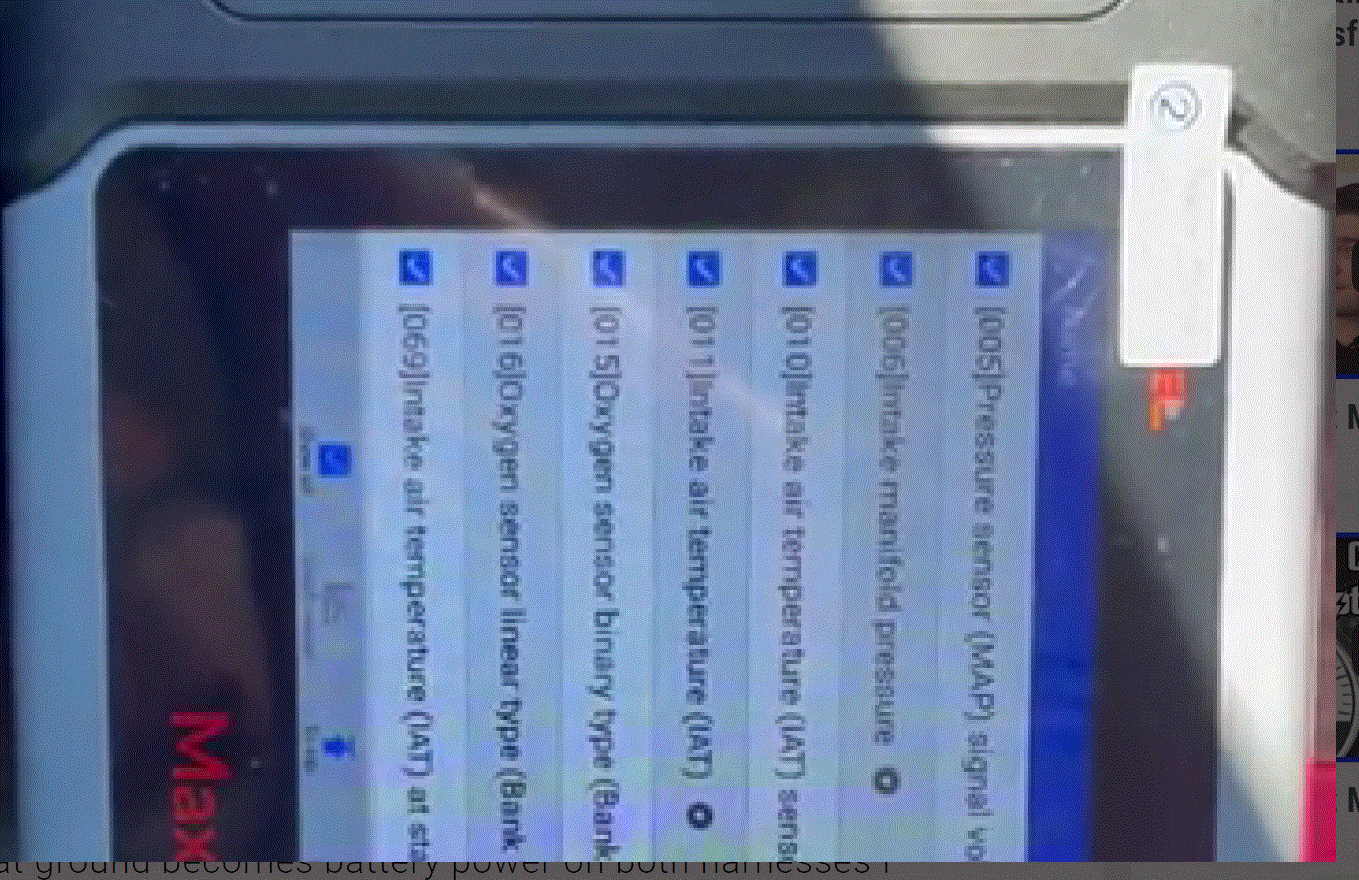

Okay, are you able to get the short-term fuel trims? Also, did you take notice of the IAT signal?
Nov 25, 2021 at 10:19 AM
DIVIDES
  • 903 POSTS
I will get fuel trims. What you mean by take notice? You mean get the value from scanner?
Nov 25, 2021 at 12:23 PM
  • 110,248 POSTS
Let's see what the trims are. As far as the IAT, you are exactly correct, the values. Let me know what you find.

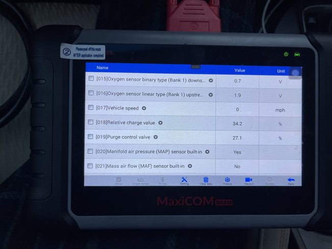

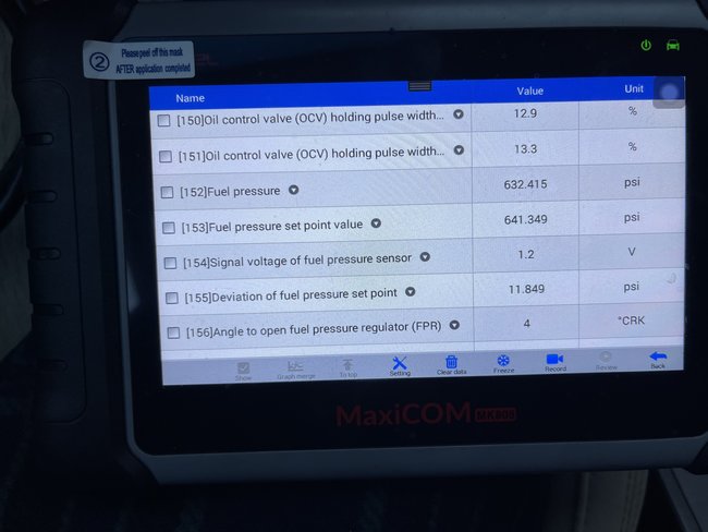

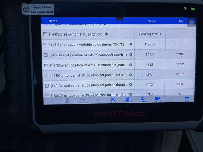

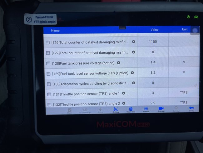

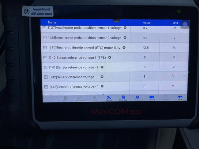

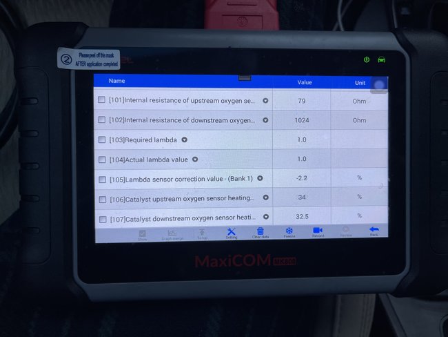

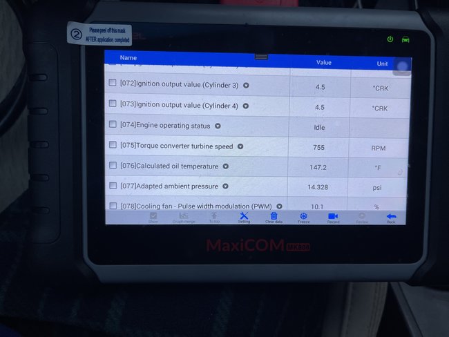

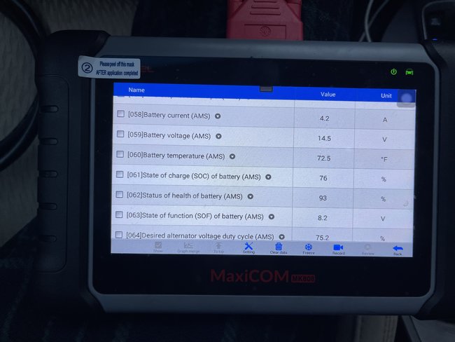

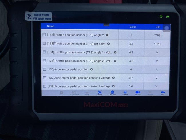

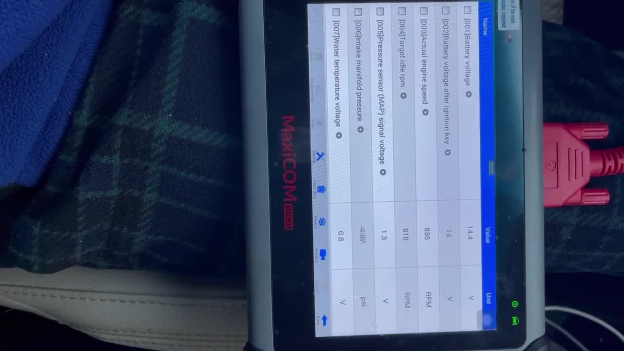

Here are some data. Also if the car is running and i pull each coil's harness the motor changes, all of them work, so this is weird.

How long does it take for the code to return? Also, I wasn't able to see results on the scanner, just the headings.
Nov 26, 2021 at 12:56 PM
DIVIDES
  • 903 POSTS
Sometimes fee miles before the check engine light is back. I just rewatched the video clip, you couldn't see the values?
Nov 26, 2021 at 1:11 PM
  • 110,248 POSTS
I attached a pic of what I'm seeing. Take a look.
Nov 26, 2021 at 2:17 PM
DIVIDES
  • 903 POSTS

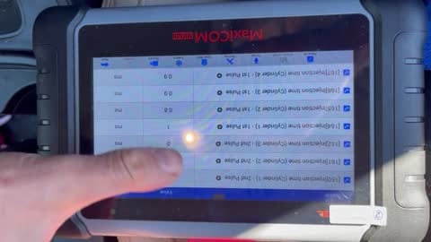

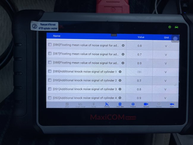

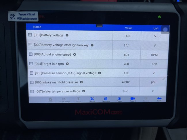

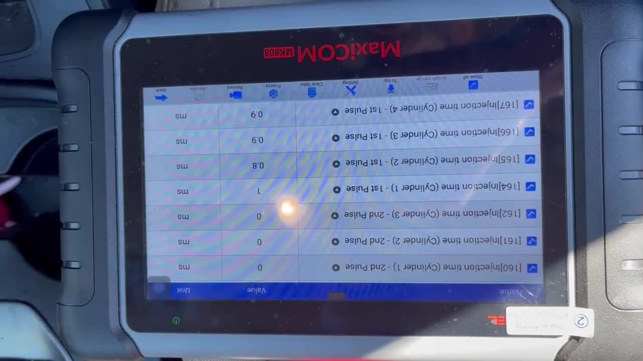

Strange, i sent a full view video.
Nov 26, 2021 at 10:45 PM

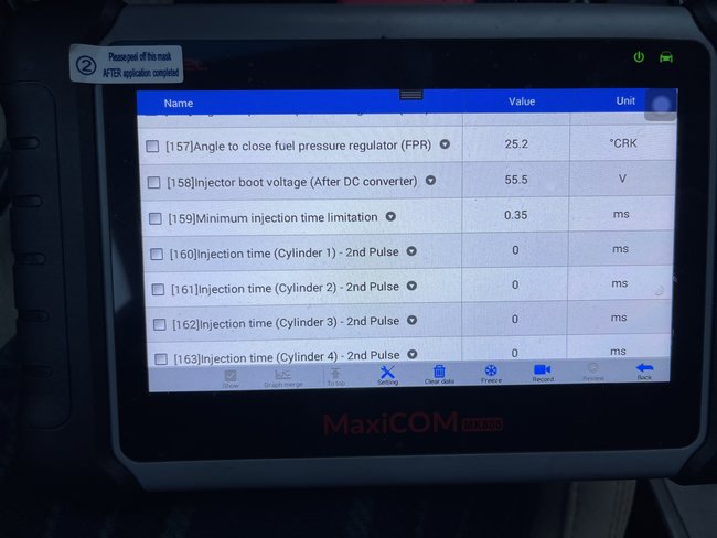

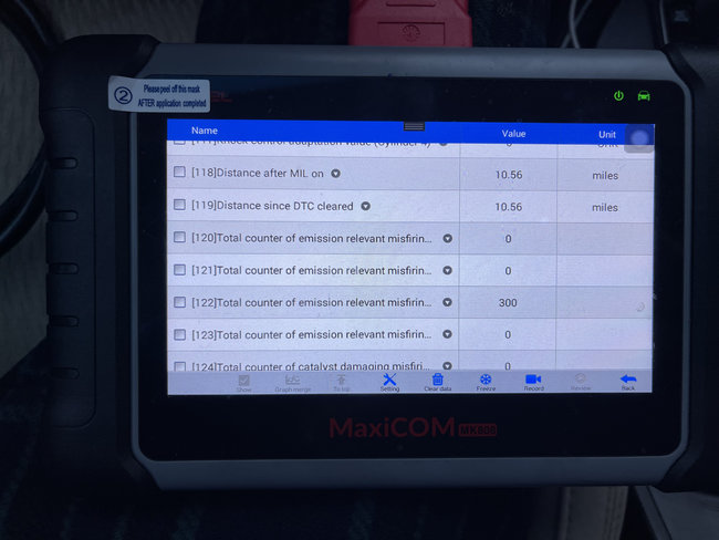

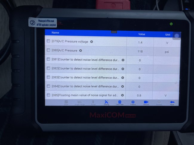

DIVIDES
  • 903 POSTS

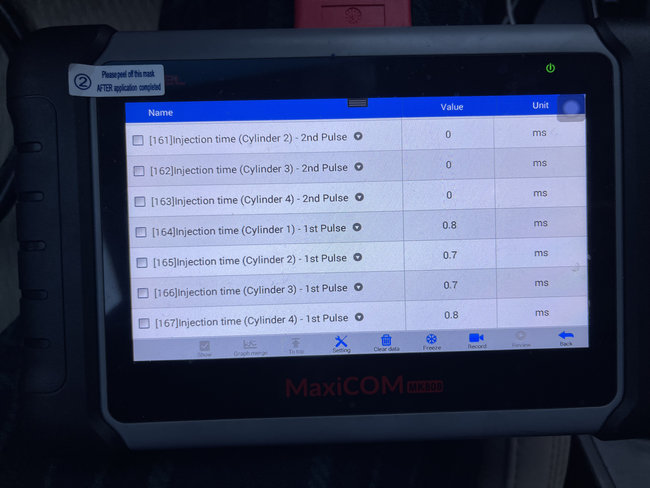

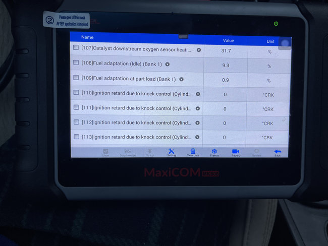

Took pictures and videos of all data, some may not apply.
Nov 27, 2021 at 6:45 AM
DIVIDES
  • 903 POSTS
More.
Nov 27, 2021 at 6:54 AM
  • 110,248 POSTS
I got it that time. LOL Interestingly, other than 300 misfires on the affected cylinder, I don't see anything that sends up a red flag.

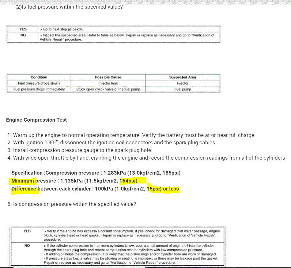

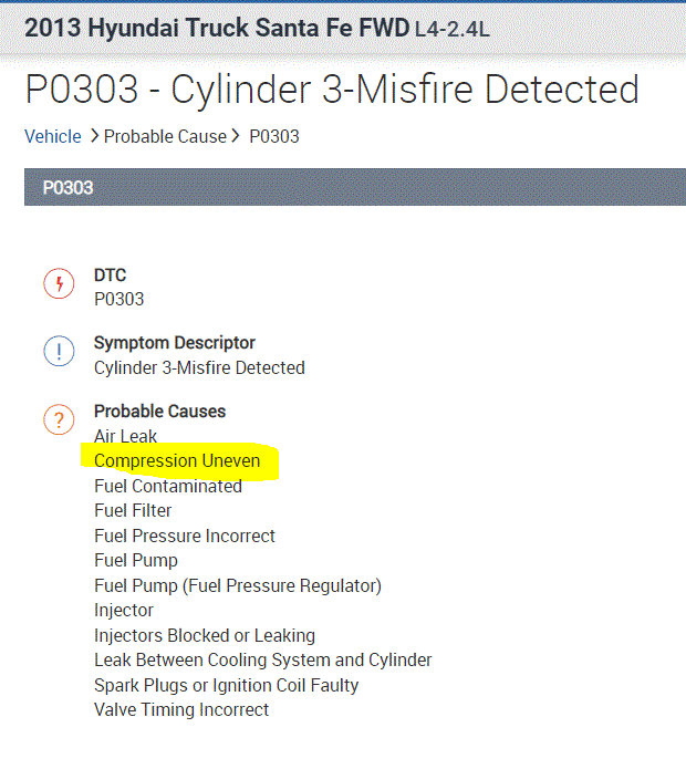

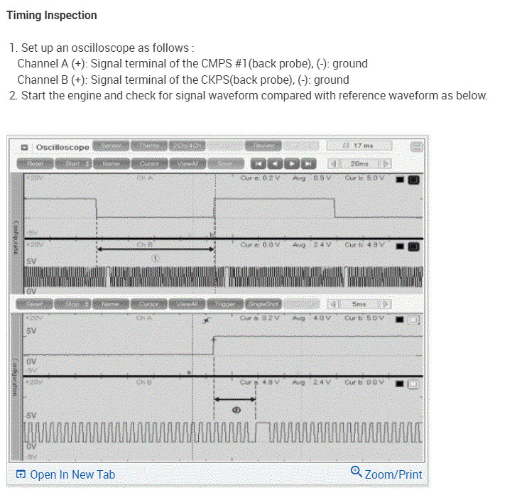

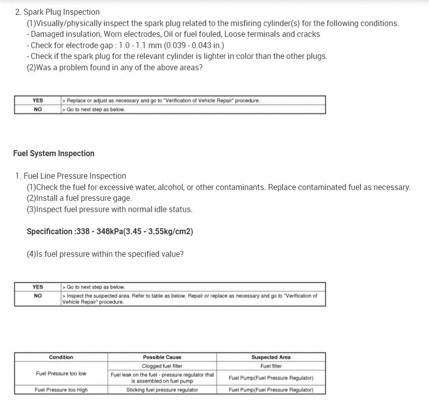

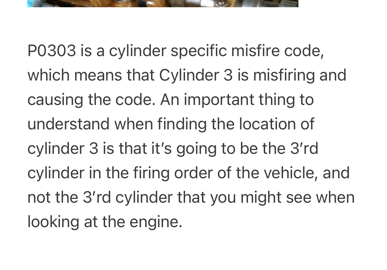

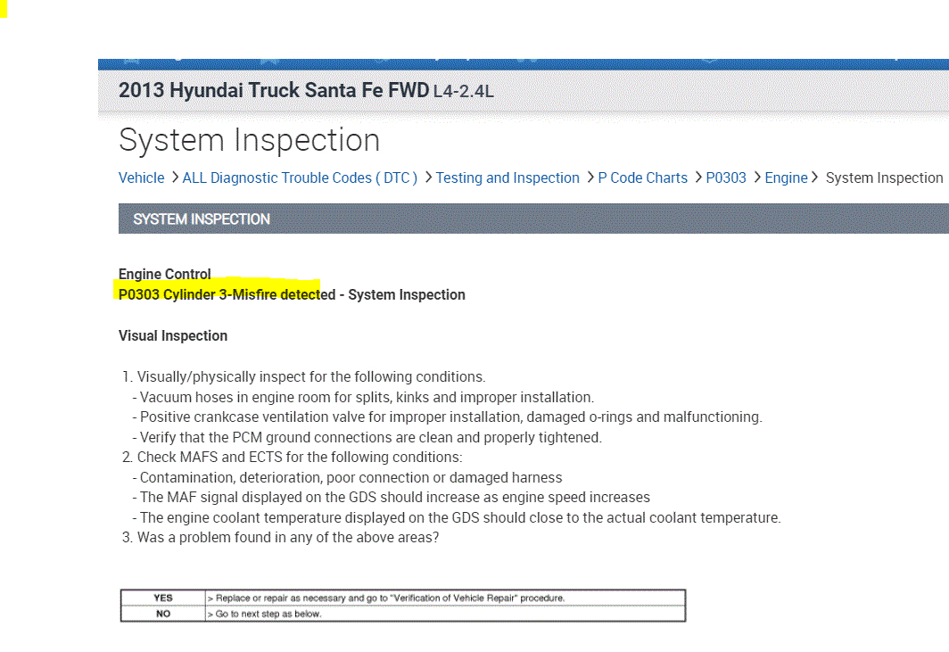

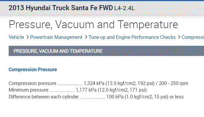

By chance, have you checked engine compression? We may have a weak cylinder. If you look at the pic below, I feel the other things would cause more than a single cylinder to misfire. At this point, I would check compression. Here is a link that shows in general how it's done:

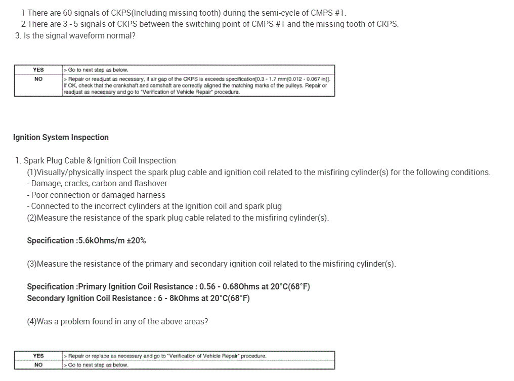

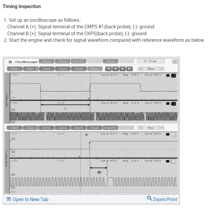

Starting with pic 2, I provided the diagnostics specific to a cylinder 3 misfire. One of the tests is compression. The manufacturer's specs are in the test. I know some of these things you have already done. Also, one test includes the use of an oscilloscope. I'm hoping your scanner can do it.
Let me know your thoughts or if I can help in any way.

Have not checked compression as if it was low i would think the misfire would be there all the time and not sometimes and wouldn't stop if i delete the code. But i will measure it.my scanner may have oscilloscope, i don't know if I will be able to measure it based on the description, I will try.

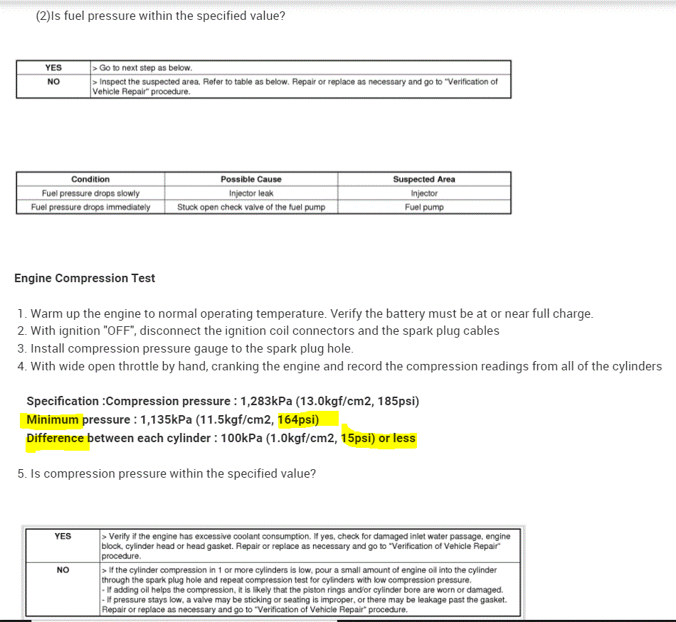

150 PSI or so on all except cylinder 3 120 PSI.
Nov 29, 2021 at 2:54 AM
DIVIDES
  • 903 POSTS
Is it possible it's just stuck?
  • 110,248 POSTS
That is enough difference to cause the problem. What to do is perform a wet test. Place about a tablespoon of motor oil in the affected cylinder and recheck it. If the compression jumps up near the others, then you have an issue with rings. If there is no change, it is likely related to one of the valves or even a head gasket.
Try the wet test and let me know the results. Also, based on the manual, they are all low. Take a look at the specs below. Also, more than 15psi difference is a problem.
See pic below.
Nov 29, 2021 at 8:58 AM

Anything is possible. I've never used the product, but I have heard it has helped others. What I am surprised about is what they indicate minimum compression to be. I feel that is high.
Nov 29, 2021 at 1:08 PM
DIVIDES
  • 903 POSTS
Not following.
Nov 29, 2021 at 10:35 PM
  • 110,248 POSTS
First, the product you mentioned is what I'm referring to. I never used it. Also, what the manual indicates as minimum compression seems high to me. I thought it would have been lower.
Nov 30, 2021 at 7:55 AM
DIVIDES
  • 903 POSTS
Yes, same here. Doubt it should be this high, and if it was that the engine is running like it does now at such low readings, and doesn't make sense that three were all at 150. So, must be around that much. Plus, there is wear and tear. Maybe when it's new it was that high, but i doubt too. Thanks
