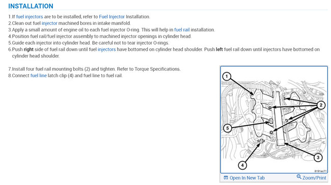

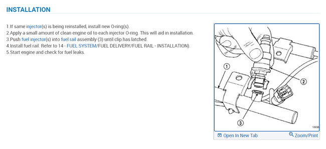

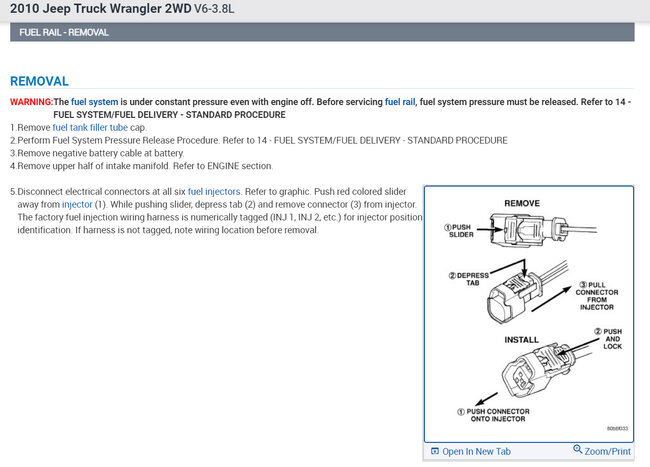

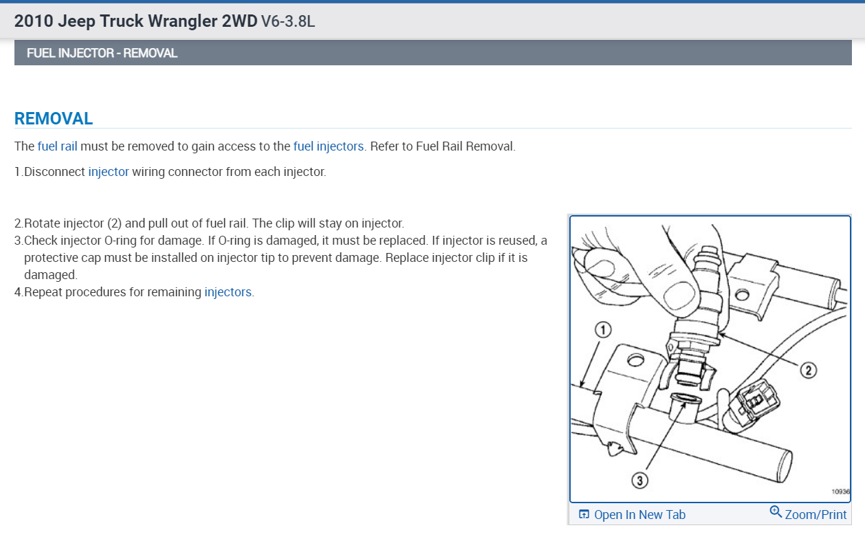

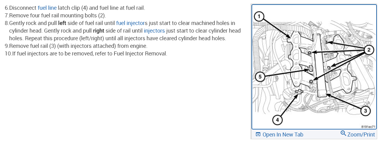

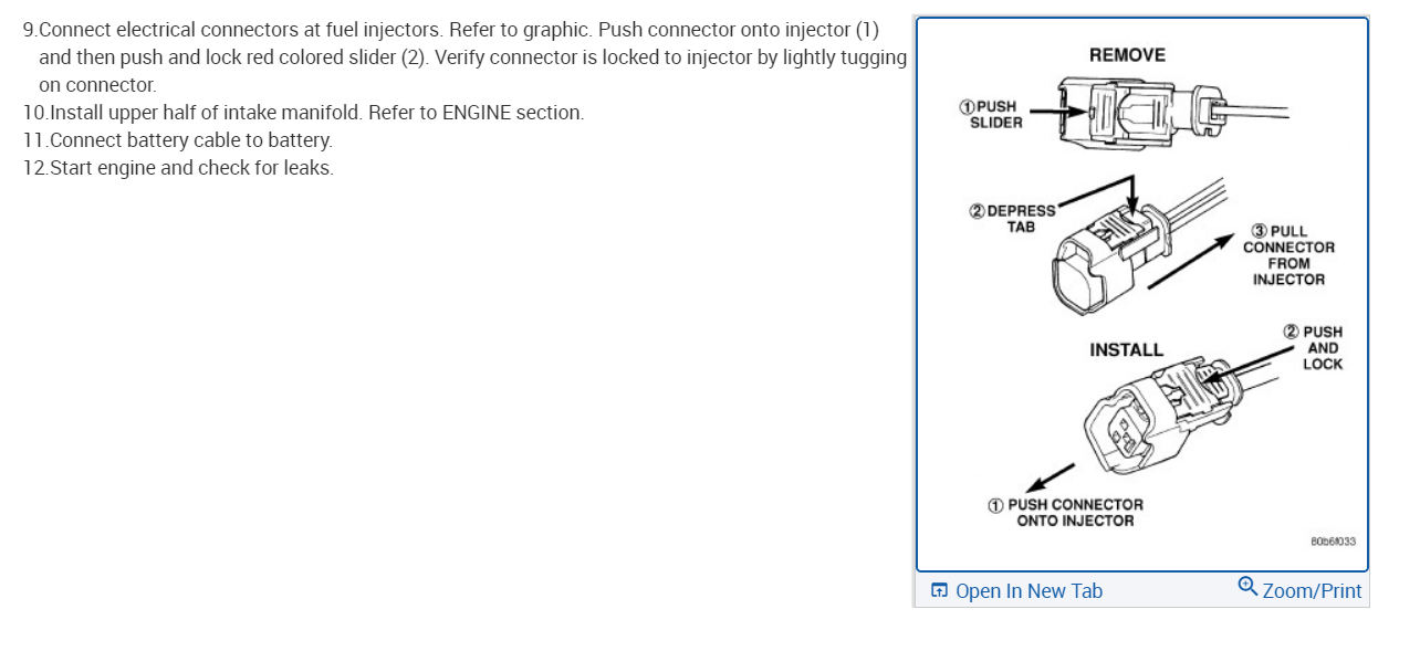

Yep, the fuel injector would be next. Can I ask if the engine is making a slight ticking sound? If so, can you please shoot a quick video with your phone so I can hear the noise? that way I can tell for sure what's going on. You can upload it here with your response. You might have a valve train problem.
Here is how to change the fuel injector out and a guide on misfire problems:
and
https://www.2carpros.com/articles/symptoms-of-engine-misfires-a-step-by-step-guide

Okay, thank you. No ticking, so my next project will be injectors, should I replace all 6 while I have it apart being it has 275,000 miles and I don't know if they are the original ones?
May 23, 2023 at 3:10 AM
  • 55,423 POSTS
Yep, that would be the next step. Also, I have seen these engines have a lot of intake port carbon build up which can cause misfire issues. Have you done a compression test?
Please go over this guide and get back to us.
