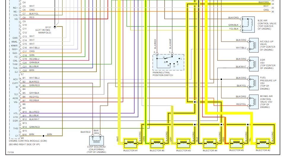

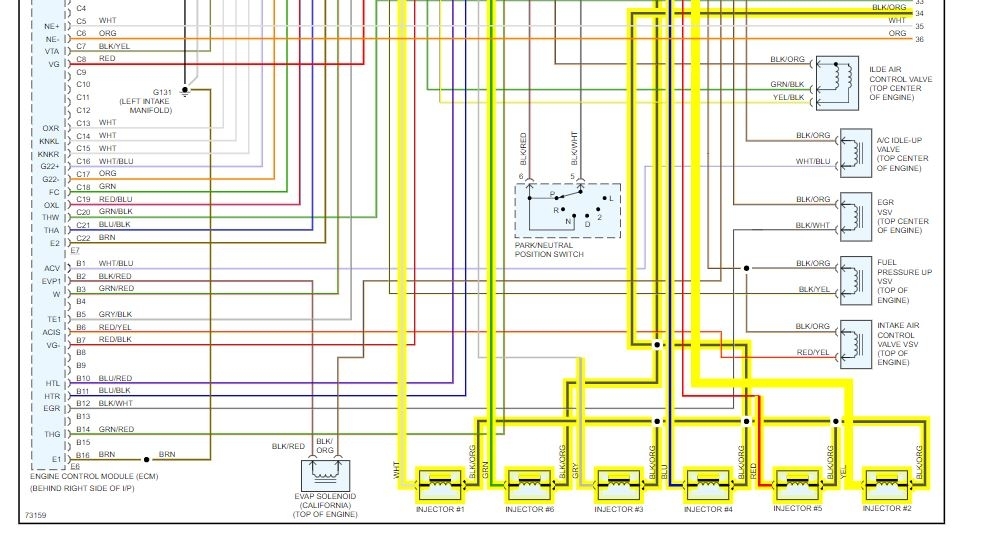

I have a misfire code, which is P0302. After doing various diagnoses, it has been definitely determined that the issue is with a bad ground wire on the fuel injector connector on the cylinder with the misfire code.
I replaced the entire ground wire for that cylinder with the misfire code from the fuel injector connector all the way to the ECM just to be sure, even though I didn't even see a broken or chewed up wire. This didn't resolve the issue.
The car has a V6 cylinder and I also diagnosed the other 5 fuel injector connectors. The ground wires for all those 5 fuel injector connectors are fine.
Since replacing the ground wire didn't resolve the issue, is there anything you can suggest I try out at this point?
For the time being, as an alternative method, I decided to splice and share the functional ground wire from the adjacent cylinder. In other words, I now have two fuel injector connectors sharing the same ground wire. This method has worked and has resolved the misfire issue. However, my concern is if this method is an acceptable resolution or is there any type of downside or hazard this could cause? Preferably, I would much rather have a dedicated ground wire for the cylinder with the misfire code instead of sharing a ground wire from another cylinder. Thank you very much for any help you can provide.

The ECM is what controls the ground for the injectors.
When you shared a ground and the misfire went away, that tells me the ECM is not good. The quad driver for that cylinder is failed inside the ECM.

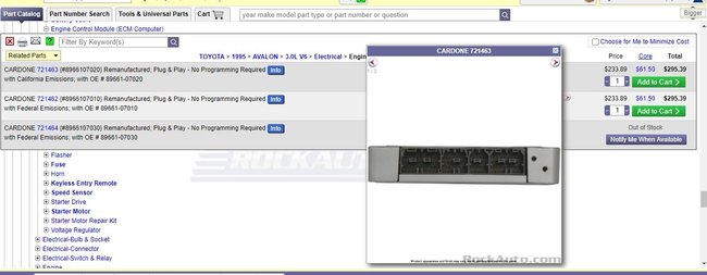

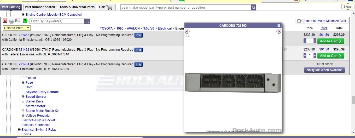

You cannot share a ground for the injector. They each have there own wire to the ECM.
You could try a used one but I never suggest used modules for any car as they may be worse than the one you have.
I attached the replacement from rock auto for you.
The ECM is a plug and play. No programming required at all.

Are the fuel injectors in this car ground wire controlled or power wire controlled?
Jul 30, 2020 at 5:36 PM
They are ground controlled by the ECM. The power is supplied to the injectors from the fuse box. The other wires go to the ECM and they are grounded to allow fuel at the correct time.
The power is supplied by a 7.5 amp fuse in the fuse box.

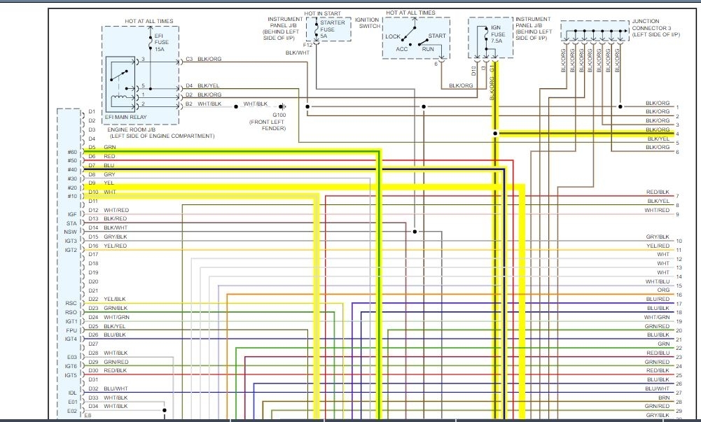

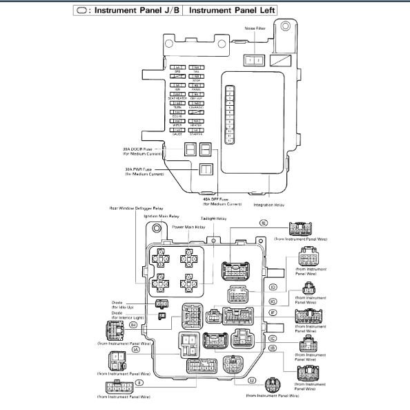

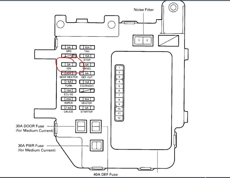

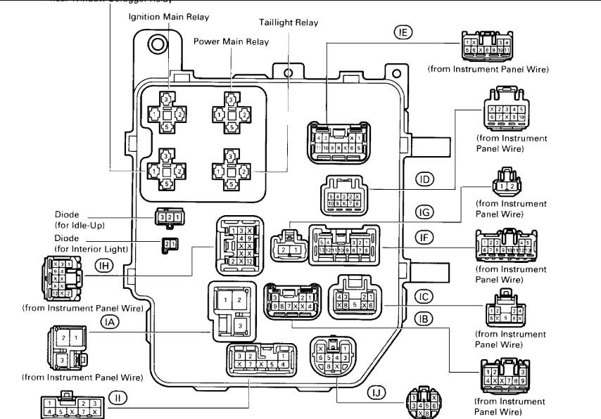

So, I understand that the ground wires for the fuel injectors are connected to the ECM and the ground wires for the ignition coils are connected to the igniter. While power is supplied by a 7.5 amp fuse in the fuse box,, where exactly are the power wires for the fuel injectors and the ignition coils connected to? Also, where is the fuse box where power is being supplied? Is there an individual fuse for each power wire or is there just one fuse for all of the power wires? Thanks!
Jul 31, 2020 at 4:27 AM
The power comes off a splice that feeds all the injectors.
I attached the diagram and location of the fuse block for you.
Test for power on both sides of the fuse.
Jul 31, 2020 at 5:05 AM
AVALON1995
  • 121 POSTS

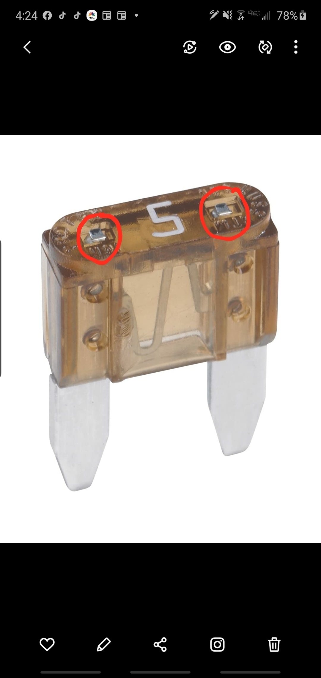

So, when you say test for power, do you mean the fuse you circled in red? Also,when you say both sides of the fuse, are you referring to what I circled in red in the attached picture? Apparently it's a 5 amp fuse, not 7 5 amp. Is there a way you can resend a better version of the picture you sent on the left? It's really not legible. The one on the right is great. Thank you!
Jul 31, 2020 at 6:35 AM
Yes, test the terminals circled with a test light with the fuse installed, key on with a test light.
Attached the enlarged picture.
Jul 31, 2020 at 6:43 AM

Sorry, I did but I failed to verify it.
Jul 31, 2020 at 7:18 AM
AVALON1995
  • 121 POSTS

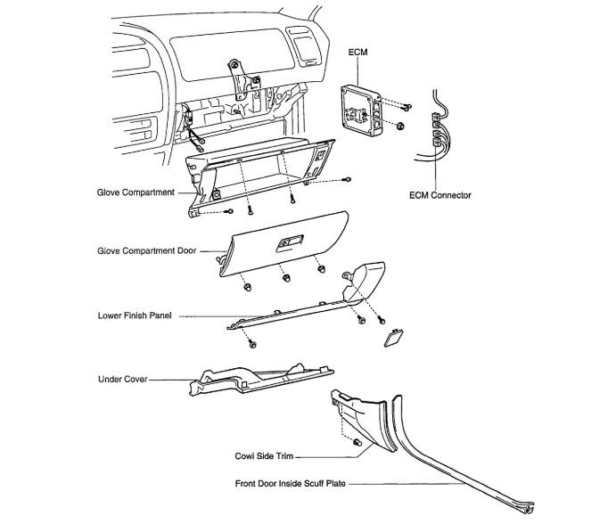

Where is this fuse box for the last picture you sent located? I know where the other fuse box is located, the one where you had circled.
Jul 31, 2020 at 7:47 AM
