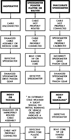

Here is what I suggest: Take a look at the flow chart I have attached. It is designed to narrow down the potential problems until you locate the problem. If you find you have additional questions, please feel free to ask. I am here to help.

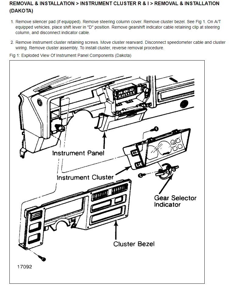

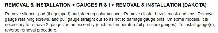

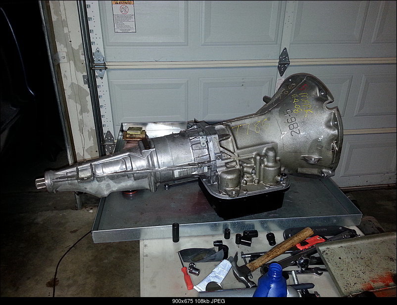

Is the speedometer cable attached to the transmission or the rear on this truck? And do you happen to have a diagram or a picture you can send me to show me. Also, could you please recommend the book/manual that I could get to be able to do extensive work on my vehicle that would include all the explosive diagrams of my truck please? Thank you.
May 15, 2018 at 12:22 AM
  • 110,240 POSTS

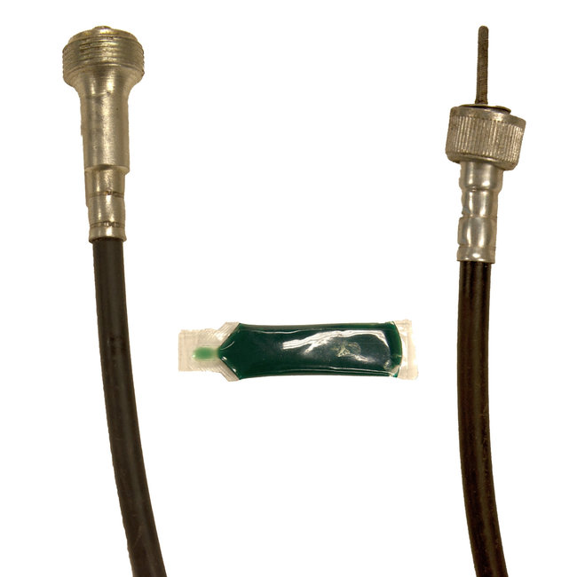

Hi again. Yes the cable attaches to the transmission. It runs to the tail housing on the driver's side of the vehicle. I have attached pictures of the cables (one with plastic end goes to back of speedometer) and a picture of a 42re transmission, which is in your vehicle and complements of the internet. I could not find a picture of the entire transmission in manuals. The tail housing is the part of the transmission which the driveshaft goes to.
