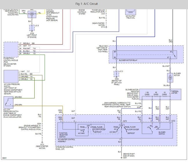

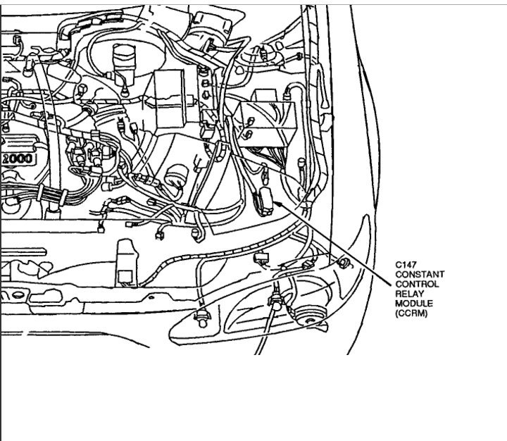

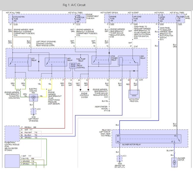

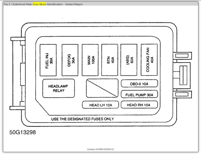

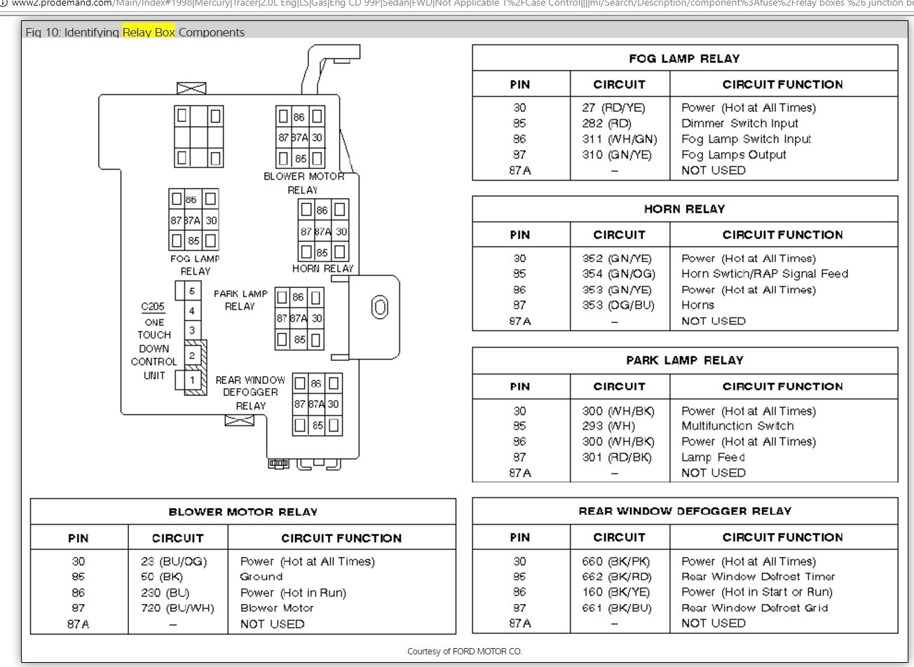

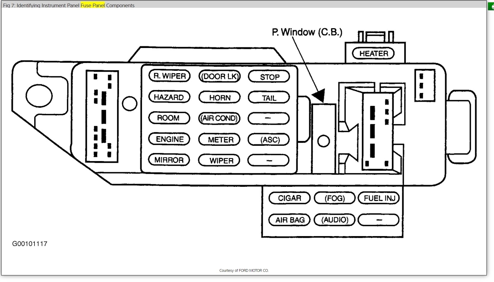

I need the exact location of the Air Condition Clutch relay that powers the the blue and white wire. The blue wire with a white tracer has no power. There is some pressure when the low pressure switch is jumped. I cannot get the AC clutch to engage. I have the diagram you sent. I need to exactly where is the relay? If I needed to put a dot of blue paint on the AC relay switch. Where do I put the bristles? Is it part of the computer. In the dash? Thanks
Mar 30, 2009 at 8:26 PM
  • 54,878 POSTS

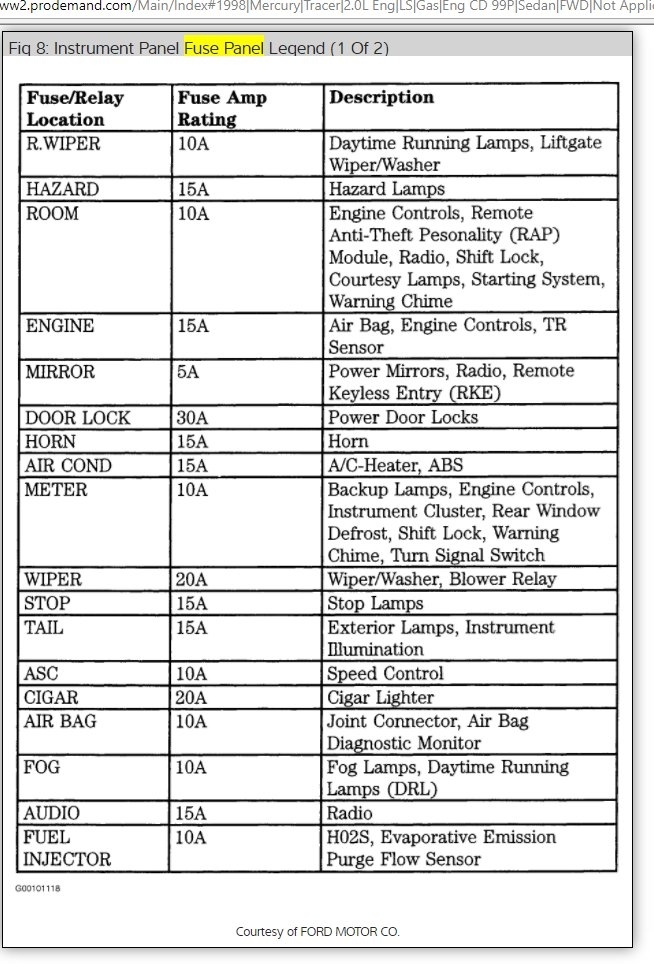

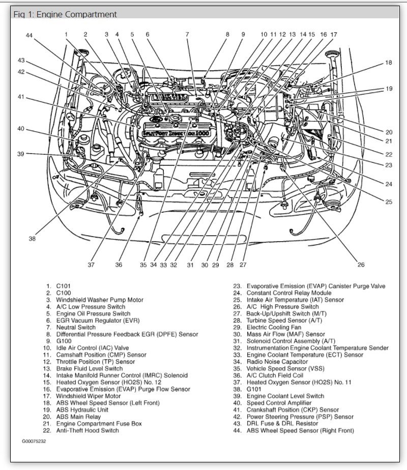

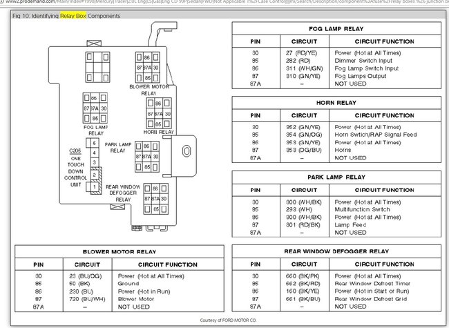

It is called a constant control relay and it is located under the hood, here are the fuse and relay locations and diagrams (below) along with some guides to help you do some testing so you can get the problem fixed.
and
and
