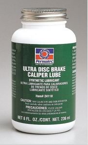

This pins must be clean and shiny prior to lubricating them ...the caliper must move on these are you'll burn out the new brakes. USe this:
https://images.2carpros.com/forum/automotive_pictures/30961_caliper_lube_9.jpg

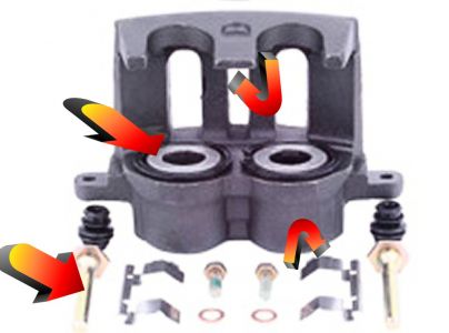

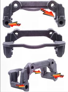

The above pics are of your caliper, the following are not, but areas that need to be clean and lubed:
https://images.2carpros.com/forum/automotive_pictures/30961_caliper_lubeareas_8.jpg
https://images.2carpros.com/forum/automotive_pictures/30961_caliper_lubeareasbrack_8.jpg
