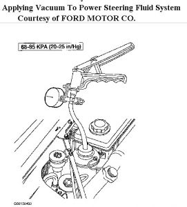

There is a procedure for this that the dealer should be aware of and done. It involves putting a vacuum to the reservior to purge the air in the system out.
https://images.2carpros.com/forum/automotive_pictures/30961_purge_1.jpg

In a sense. A few days should be enough to allow air escape. Ford power steering pumps are more apt to need this bleeding procedure. I don't expect it to go away, without doing this.
