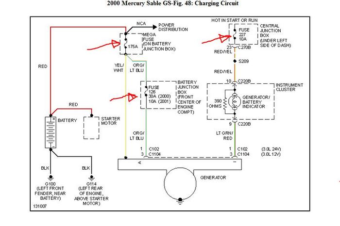

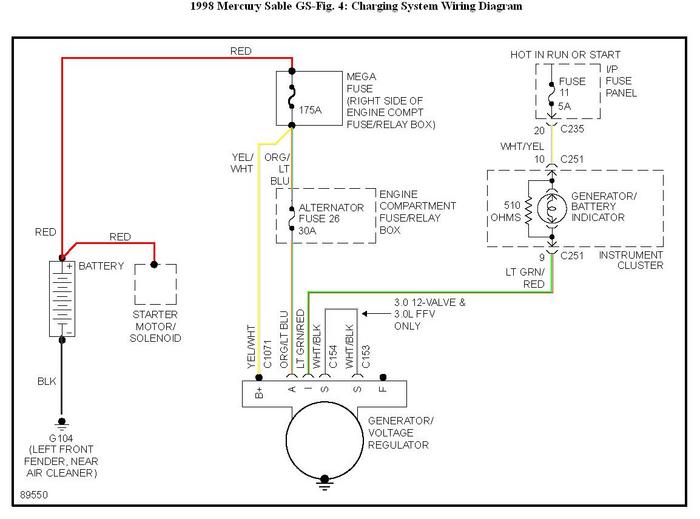

Would it be the mega fuse? Alternator is new been tested again and is good. However, it is not charging on car.
Sep 7, 2008 at 5:47 AM
  • 55,423 POSTS

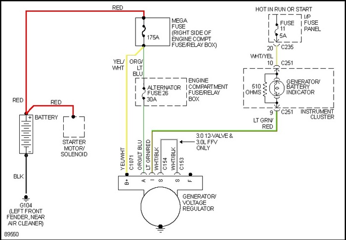

There must be a bad connection somewhere are a blown fuse. Here are to guides and the alternator wiring diagram so we can do some testing.
and
and
(Check out the alternator wiring and fuse panel diagrams below)

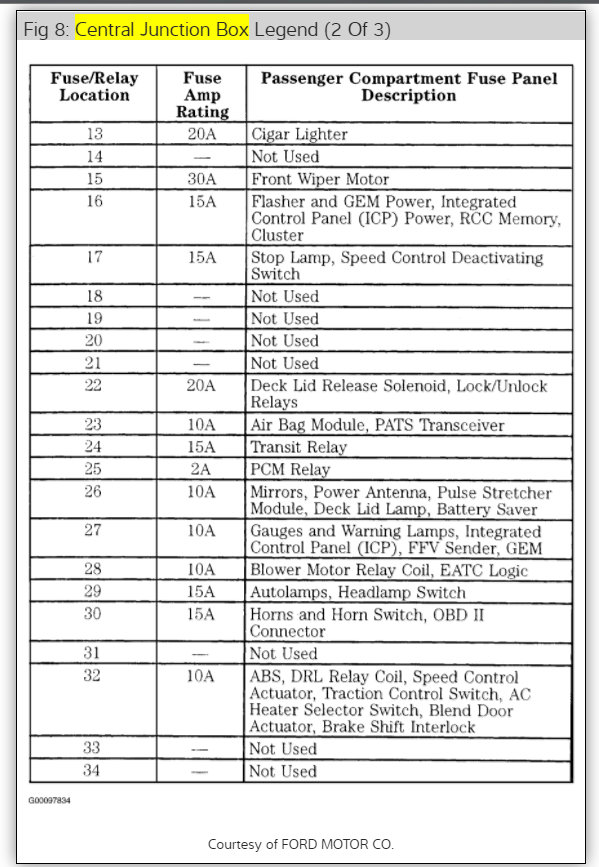

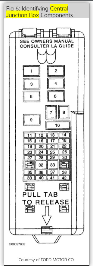

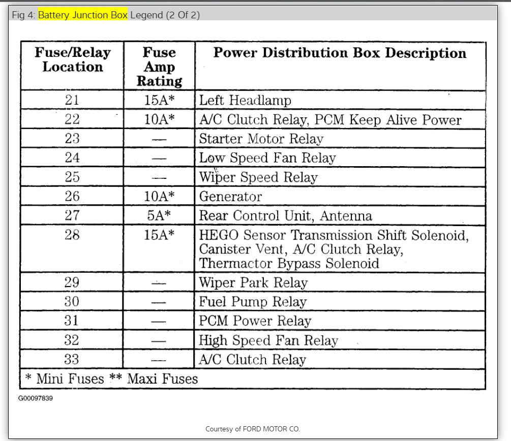

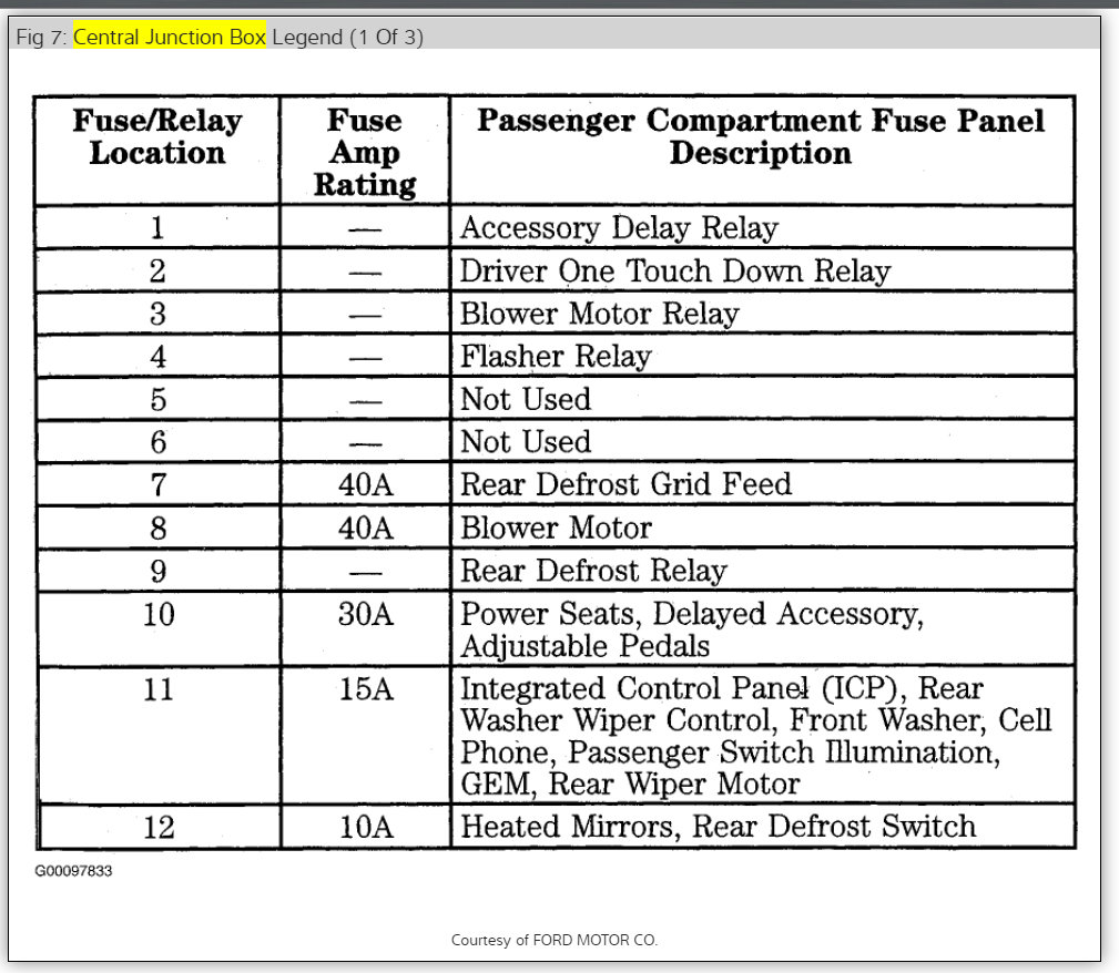

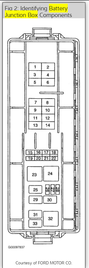

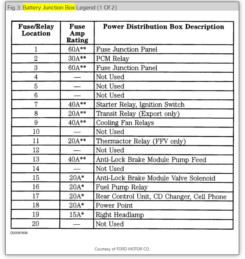

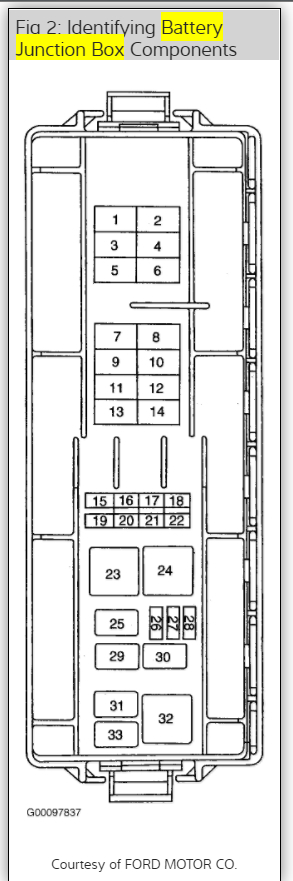

There are 3 fuses in the system that will need checking, see pic for locations, start here.

Ok I have a 03 Mercury Sable DOHC. I've replaced the alternator twice now and warrantied out the battery twice. Im still having charging issues. I've checked all the fuses including the mega fuse on the side of the fuse block under the hood. It has 12.1 volts on both sides of that fuse and at the battery. I can't figure out this problem for the life of me. Any help you may have would be very useful.

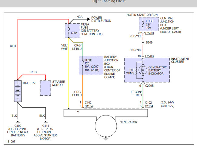

Attached is a schematic of the charging system.
The followng must be hot at all times :
1. Yellow/White wire.
2. Orange/Light Blue wire. (Disconnect to test)
Is the charge indicator light showing when igniton switch is turned on?
Does charge indicator light turn off when engine is started?
What is the voltage at B+ (Yellow/White wire) when engine is not running?
What is the voltage at B+ (Yellow/White wire) when engine is running?
What is the voltage between battery terminals when engine is not running?
What is the voltage between battery terminals when engine is running?
Nov 26, 2017 at 12:07 PM (Merged)
DSQUARE63
  • 9 POSTS
yes the light is on with key and runnin. both wires are hot. and the voltage on all those questions is not running it is about 12.4 when you start it drops to about 10.6 and as it runs it drops

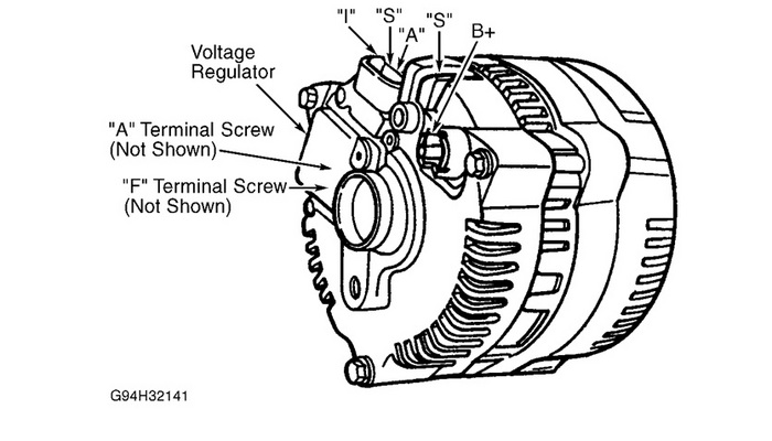

JDL
  • 16,098 POSTS
With the key on, any voltage at the I terminal at multiwire connector? I looked at info for a motorcraft generator.

JDL
  • 16,098 POSTS
Charging system wiring, below.

JDL
  • 16,098 POSTS
There may be a problem with indicator lite or wiring. The info shows a resistor to bypass the lite incase the lite-bulb vibrates out socket, or goes out. Does the charge lite on the dash work?
I've seen diagrams like this before, with the bypass, generator would not charge unless lite was fixed.

CARADIODOC
  • 34,381 POSTS
The voltage regulator controls charging rate. It's bolted to the back of the alternator. If you look at it, you will see the four mounting bolts, and two more in between them. One might have a plastic cap on it. The other one is labeled "ground here to test. Let the engine idle, and ground that terminal. Watch the charging voltage at the battery and at the output wire. If they go up a bunch, say to 15 - 18 volts, the regulator is suspect.

The fuse is in the diagram, goes hot/voltage with key on. If fuse is ok, use voltage tester at fuse leg, where the fuse plugs in.

you are the man! replaced the fuse and alternator is charging the battery to 14.25 v

KHLOW2008
  • 41,814 POSTS
The Orange/Light Blue wire should have battery voltage. With engine off, unplug the alternator and test the Orange/Light Blue wire. If voltage is not avaliable or not battery voltage, check the voltage at alternator fuse # 26 in engine compartment fuse and relay box.
If battery voltage is available, check for poor continuity between fuse and alternator.
Try applying battery voltage to Orange/Light Blue wire and test if charging is as desired.
