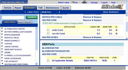

I understood that fixing heater core is costly and thermostat is cheap. How's about repairing other stuffs you suggested? Are they costly too? Let says problem is heater core. roughly how much do i have to spend heater core this car model(93 mercury sable)? Thanks!
Dec 28, 2008 at 3:55 AM
  • 75,988 POSTS
Both could be costly See below-Labor/Part could range from $70.00 to $130.00 per hr varies with location-shop around
https://images.2carpros.com/forum/automotive_pictures/12900_heater_core_3.jpg
