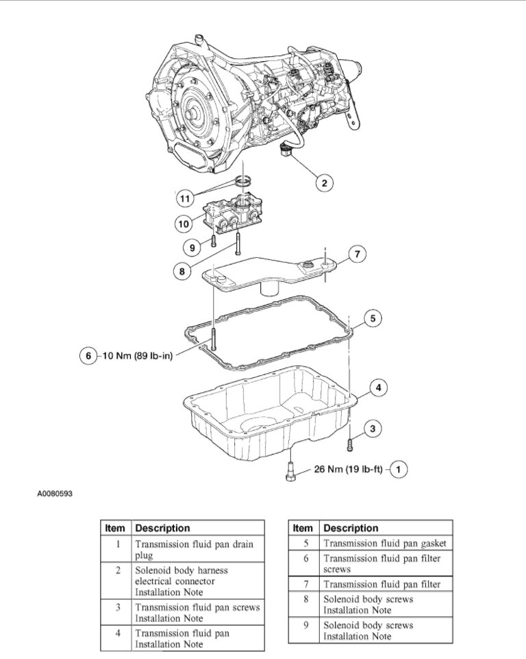

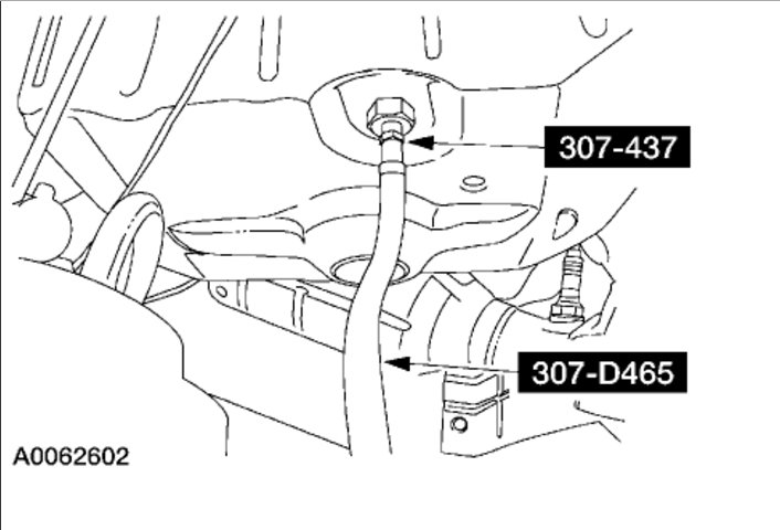

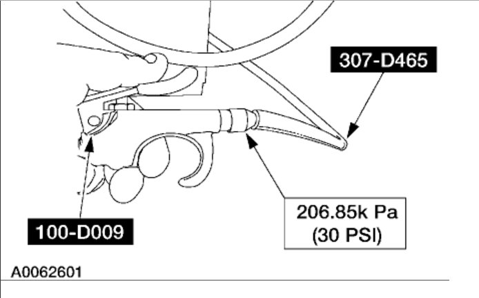

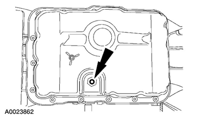

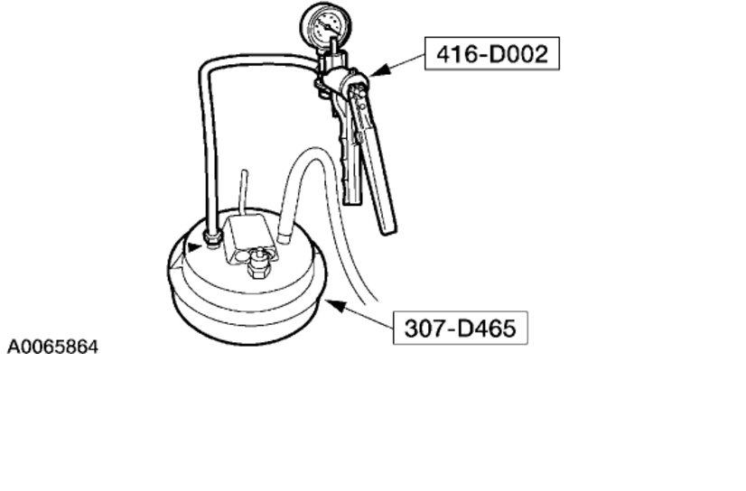

I just drained and changed the transmission filter, but I noticed there is no dipstick to add the new fluid. So where exactly can I try to add the fluid?
Mar 14, 2010 at 8:46 AM
  • 110,244 POSTS

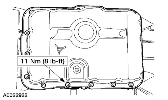

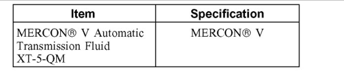

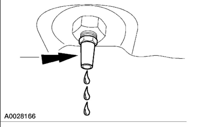

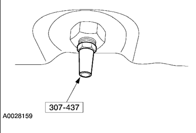

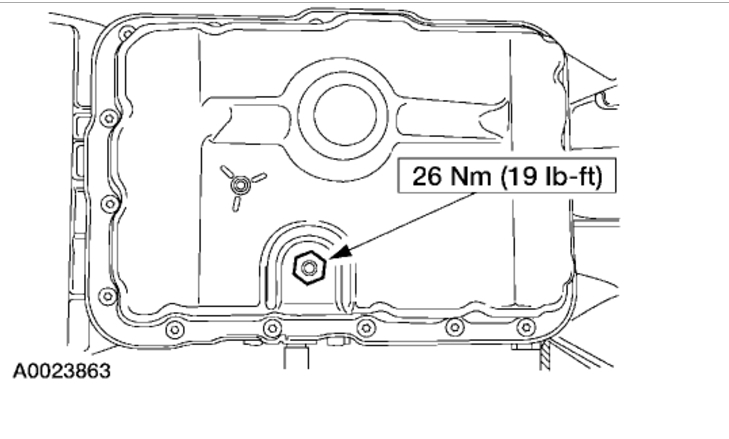

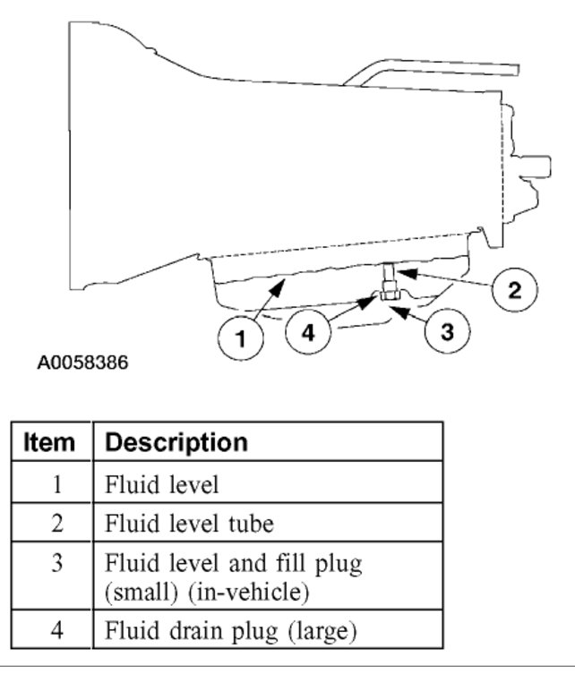

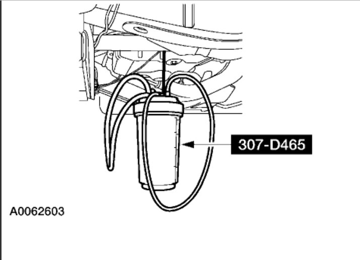

The fluid is installed from the oil pan. Here are diagrams to help you see how to do the job:
Cheers

How do you check the transmission oil in a sealed transmission? And can you replace the oil in a sealed transmission?
Aug 25, 2018 at 12:22 PM (Merged)
  • 110,244 POSTS
The transmission fluid can be checked for level. There is a bolt in the side that is removed. If the fluid comes out, level is okay. Service work should be done by a dealer.
