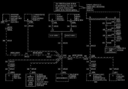

Hi: The speed sensor isn't part of the trans. Here is a schematic of how it's wired into the system. If this isn't the problem, I would be in touch with the rebuild company.
https://images.2carpros.com/forum/automotive_pictures/249084_speed_sensor_1.jpg
I hope this helps. Joe

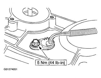

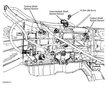

Ok, I was able to locate 3 different ones. Although it's not part of the trans, there is a VSS out put on the top of the trans. Here is a picture of one and its location.
https://images.2carpros.com/forum/automotive_pictures/249084_trans_1.jpg

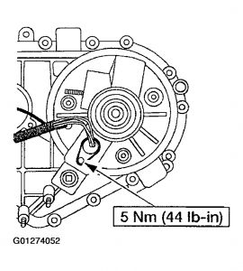

There are two more on the transfer case for the auto 4wd, but I don't think this is the problem. Here are their locations and pictures. Both are on the transfer case.
https://images.2carpros.com/forum/automotive_pictures/249084_sped_sen_1.jpg
https://images.2carpros.com/forum/automotive_pictures/249084_speed_1.jpg
Let me know if this helps. The one on the trans will be hard to access. That is the only problem I see, and I think that is the one you want. Let me know if this helps. Joe

Thanks again Joe You refered to a VSS on the top of the transmission but none of the three in the top drawing are specifically called a VSS. One is the turbine shaft speed sensor, one is the intermediate shaft speed sensor and one is the output shaft speed sensor. Is the VSS you refered to one of these?

I spoke with another mechanic and he said it's the one on the rear of the transfer case.
Let me know how it works out for you.
