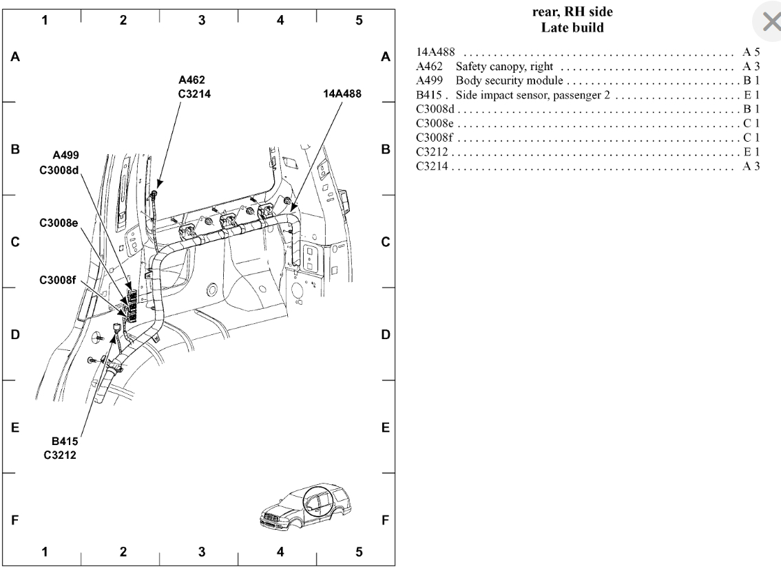

key-less entry module location?
2002 MERCURY MOUNTAINEER
JEREMIAHJOHNSON
I need to know where the key-less entry module location is?
May 26, 2006 at 3:00 PM
SQM
  • 6,383 POSTS
That module is located inside the panel of the rear passenger side cargo area (see diagram).
This also called the body security module.
In order to access this you will have to remove the inside panel on the cargo area. You will be able to use simple hand tools to get the panel off. There are several plastic fasteners and screws keeps the panel in place.
