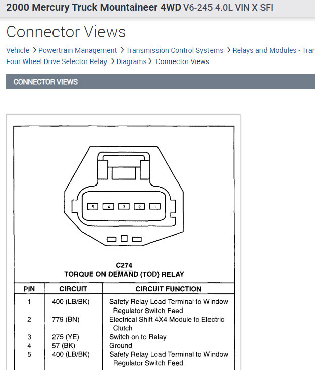

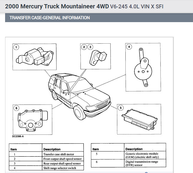

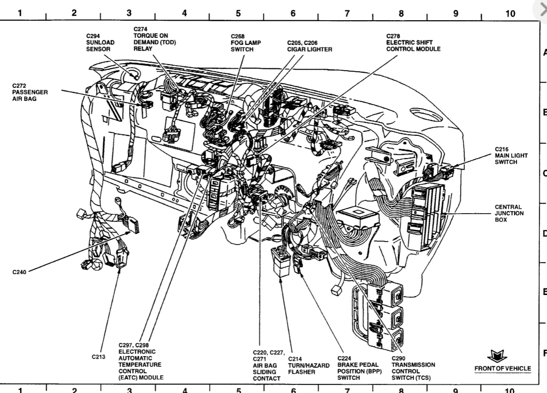

You likely have an intermittent issue with the transfer case control module.
The best way to know what is the exact issue it will need to have the vehicle scan for codes. But it may not produce any fault codes if the issue is not surfaced at the time of the diagnostics.

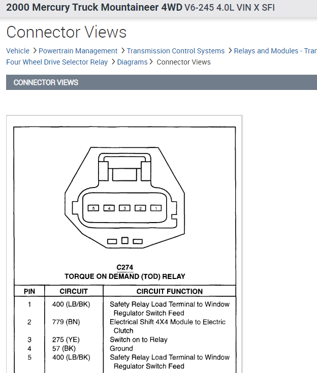

This can also be triggered by the relays for the transfer case. Those relays are located under the dash on the passenger side.
Sep 16, 2021 at 3:27 PM
Suggested Repair
Scan the vehicle for transfer-case codes, noting that an intermittent fault may not set a code if it is not present. Also check the transfer case control module and the transfer-case relays under the dash on the passenger side.
