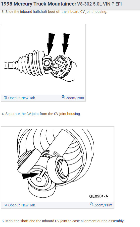

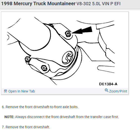

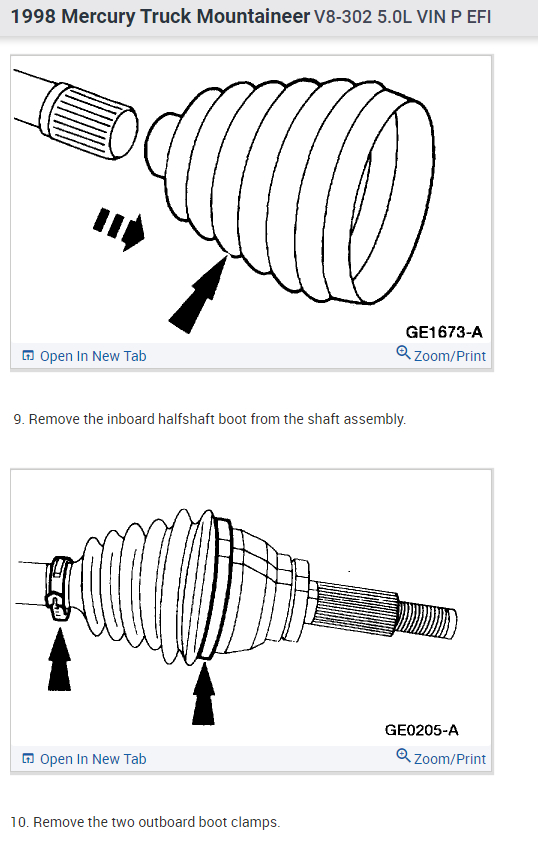

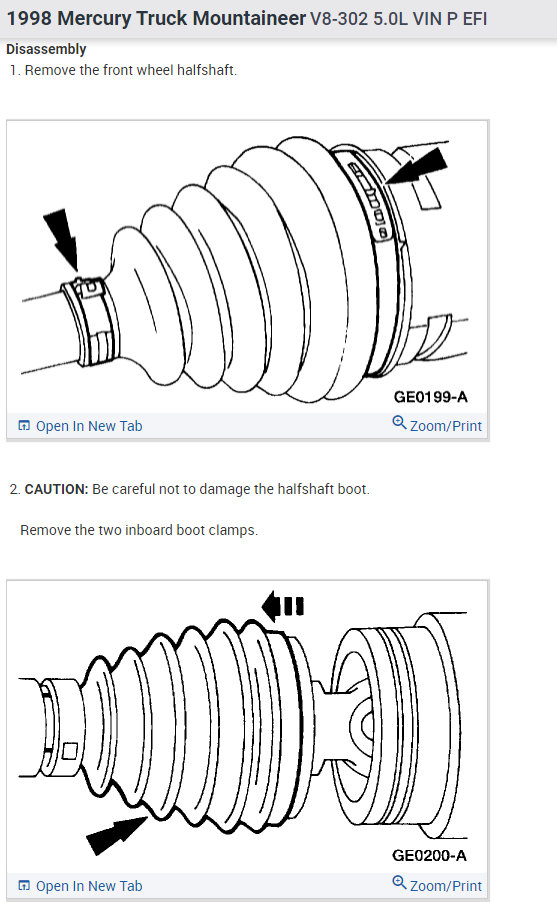

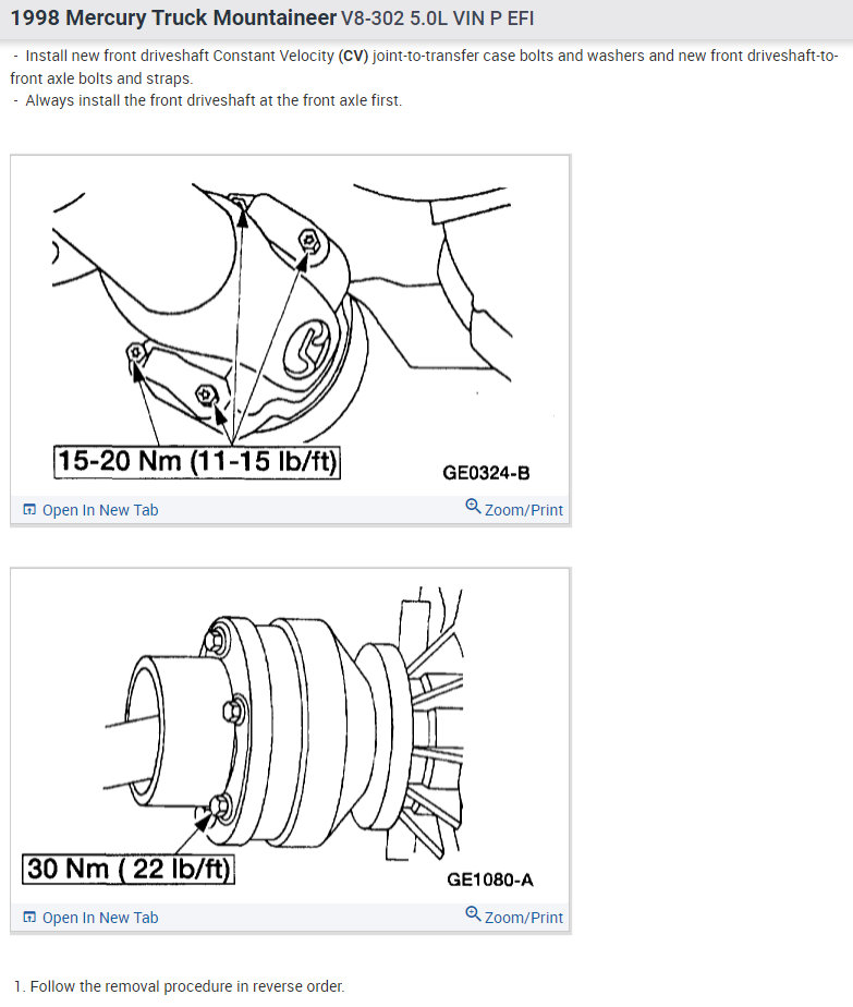

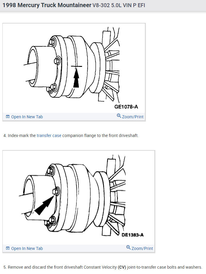

I'm hearing a clicking noise and it sounds like its coming from under the truck.
Friday, January 30th, 2009 AT 7:13 AM
SQM
  • 6,383 POSTS

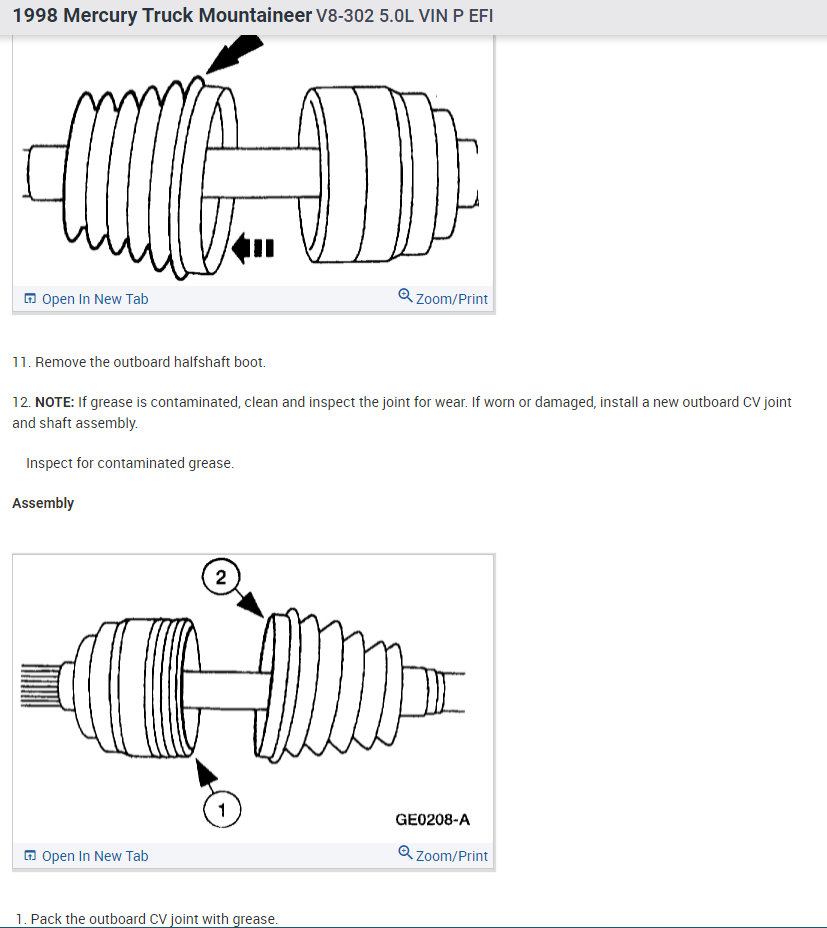

If you are hearing clicking noise as you turn the wheel, it is likely due to faulty CV axle.
The CV axle could have a damaged boot, which will allow dirt and debris to enter the joint and that typically leads to the clicking noise.
Do an inspection of the CV axle. If there is a leak in the boot you will have grease all over suspension components.
Here is a helpful guide:
https://www.2carpros.com/articles/clicking-sound
