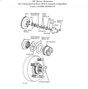

I want to replace the wheel bearings on the Front wheels. Front has Disk brakes. What do I need to do to remove the inner and outer bearings and races. Do I need some special tools?
Sep 19, 2009 at 2:34 AM
SERVICE WRITER
  • 9,123 POSTS
Why do you want to replace them? 2wd models do not have inners and outers. This is the 4wd:
https://images.2carpros.com/forum/automotive_pictures/30961_mou_1.jpg

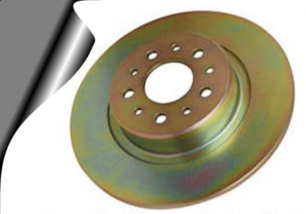

Brake rotor for 4wd:
https://images.2carpros.com/forum/automotive_pictures/30961_mou2_1.jpg

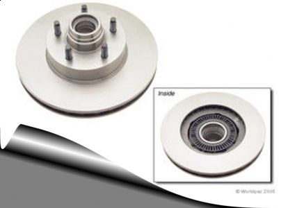

Brake rotor for 2wd:
https://images.2carpros.com/forum/automotive_pictures/30961_mou1_1.jpg

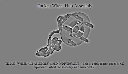

the bearing is part of the hub. http://www.autopartswarehouse.com/sku/Mercury/Mountaineer/Timken/Wheel_Hub_Assembly/19972001/TMSP450200.html?tlc=Engine+%26+Drivetrain
https://images.2carpros.com/forum/automotive_pictures/30961_mou3_1.jpg
