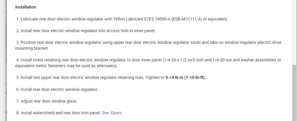

I have a 1995 Mercury grand Marquis G.S.with 175kmiles and 4.6 liter engine. I have the Mercury shop manual for it but it is not clear on how to remove the rear window glass in order to remove the regulator.I have replaced the two front regulators and the glass just slips out easily on those.The rear one is different.

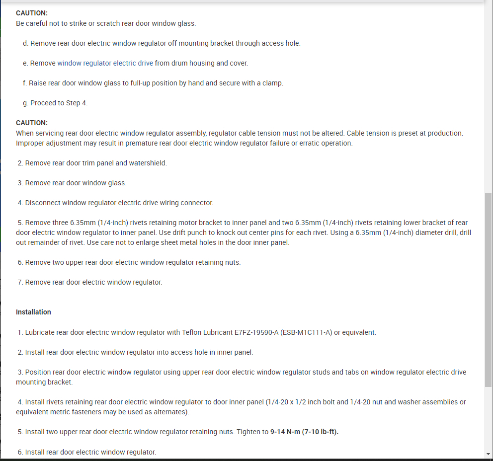

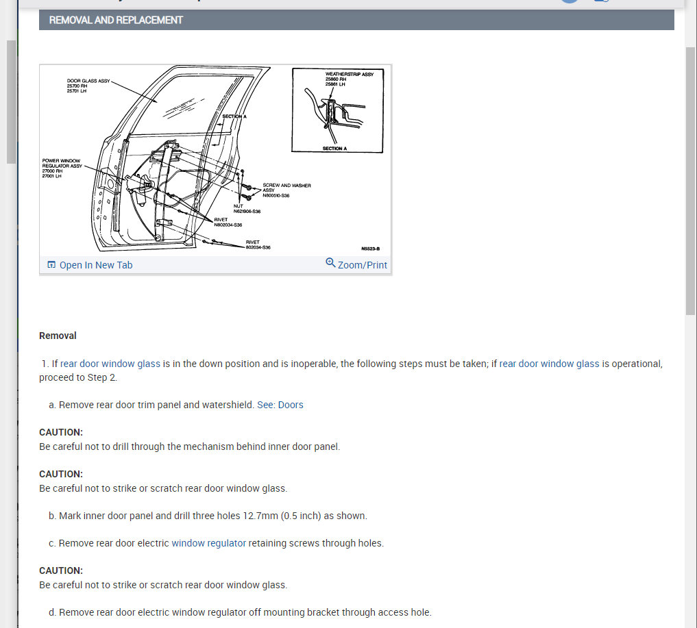

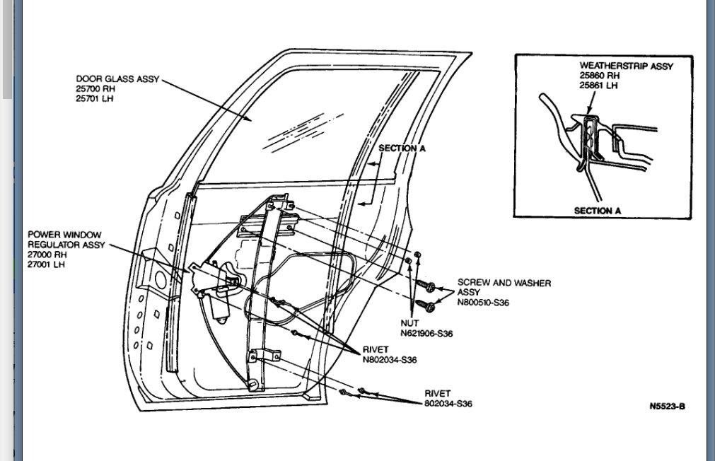

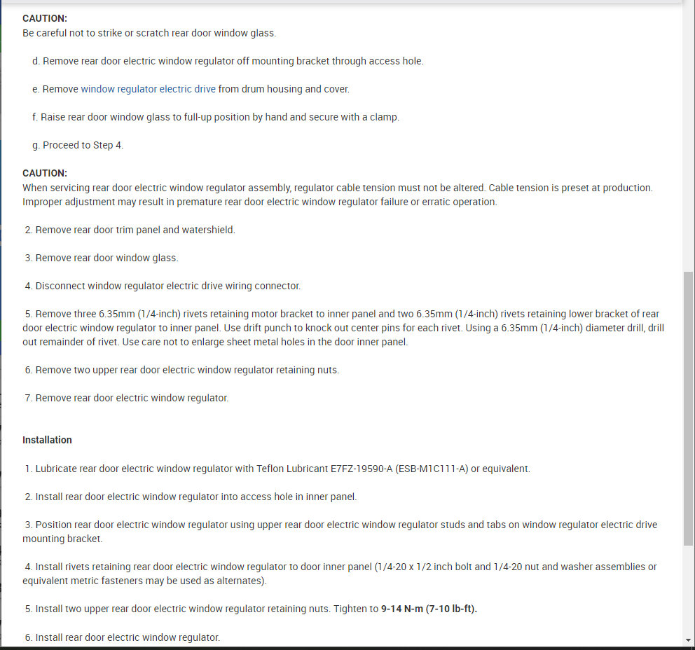

Also, I am attaching the info from the manual and they say to raise the glass to the full up position and secure it out of the way. So if you don't have to remove the glass for some other reason, this would be the best course of action.
