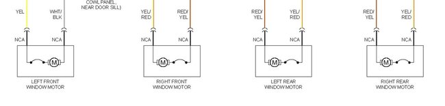

window won't go up.can i jump wires on control panel to get it up until i can buy another one.i am pretty good with wiring,just need to know wich leds to jump

Is it the driver side window? That is usually the first window motor to go out. If the motor is bad, jumping the wiring won't help. Give me a second and I'll post the wiring.

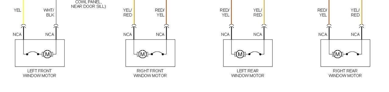

Do the other windows work ok? In the diagrams, the two wires are voltage and ground. Because the motor is reversing, the wires switch between voltage and ground, depending if the window is going up or down. Those wires connect to the back side of master switch.
