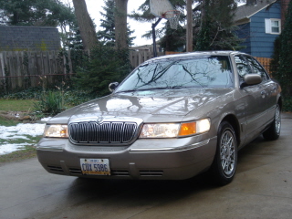

Hi every one,
I had the weirdest thing happen to me. I took my car to garage to have the radiator flushed.
When I pickup my car it started missing at 40 mph.
The TECH'S change the plugs for me and I know I Have A miss AT 55 MPH ON THE highway still.
I am wondering if flushing out the radiator fluid had something to do with making my car miss?

My 2001 Grand MArquis did the same thing. I found that one of the spark plug coils started breaking down due to getting wet. I frequently have a slight miss whenever the engine is cold and maybe has moisture in the air. Hope this helps!

I a Purchased a new COIL ON plug (COP) and by the process of elimation by removing each COP and replacing old one with the new one then going out for test drive I found the bad cop.
However, this does not explain way after my antifreeze was replaced I had such noticeable miss. Then they replaced spark plugs it to minor mis to a bad cop # 8 away from the thermostat and heater hoes.
The only I a can figure had something to dowith the coolant sensor being cleaned during flush and it was more sensitive to sending messages back to the CPU saying change your spark plugs and # 8 cop is really bad know, I the CPU can not compensate these bad plugs and cop # 8, since you cleaned antifreeze in the block.

Purely coincidence my friend. These cops fail all the time. Did you notice coolant at the end of the coil? Ive had #4 coil failing because of a light drip from the heater core hose leaking into that cylinder. Cyl #4 is the rear cyl on the passenger side.
