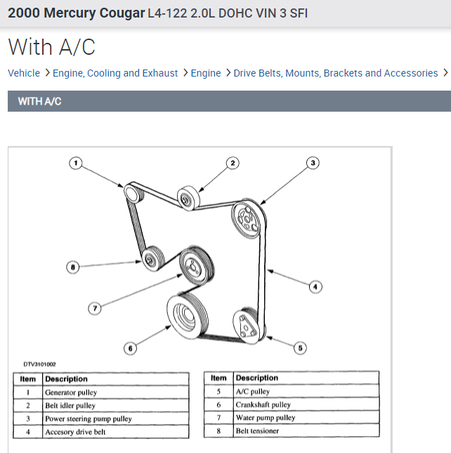

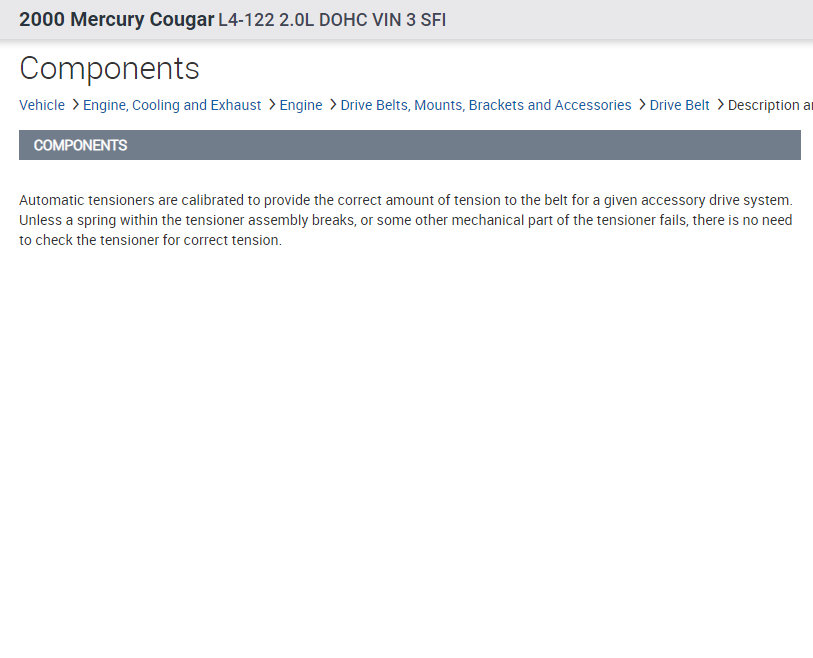

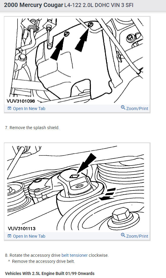

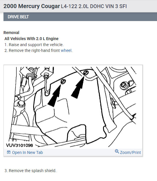

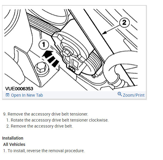

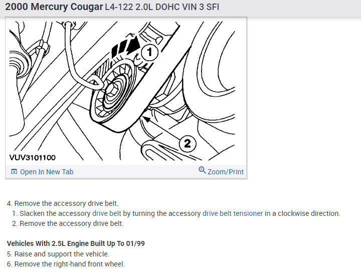

When you hear a screeching sound at startup it is typically due to a faulty serpentine belt.
It is likely is worn and glazed over. So at startup the belt will actually slip on the pulleys and that will make the squealing / screeching noise.
Here is a helpful guide that goes over this issue:
https://www.2carpros.com/articles/car-squeaking-noise
If the belt is worn then it will have to be replaced.
I have attached the belt replacement diagrams for your reference.
