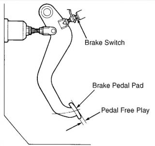

car runs great, sounds great, just charged the A/C, drove it to work several times, smells hot and burning and some light smoke coming from under hood. Then one day after a drive of maybe 6 miles I parked it, left it running to unload some stuff, left A/C on and cleaned interior winshield, got in it to back out and it would not move. Not in any gear. The break pedal seemed to not have any give in it when pushing on it at that moment. I turned it off and let it sit for an hour and then cranked it and it backed out just fine. My boyfriend took it another day to test it out and drove it for about 10 miles and while driving it just slowed down and would not go and he too said it felt like brakes were locking down but it wasn't a slam just a slowing down.

Symptoms seems to point to the brakes dragging and something seems to be causing them to be applied. Was any repairs to brake related components done prior to this occurring?
Check the brake pedal push free travel. If free travel is insufficient, the brakes would lock up after some travelling as brake is self applying.

What is free travel? You are talking to a "girl" here and I need all the descriptive information. Thank you

Free travel means the amount of movement available before the pedal pushes against the push rod of the brake booster.
https://images.2carpros.com/forum/automotive_pictures/192750_Pedal_Free_play_1.jpg
