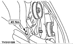

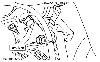

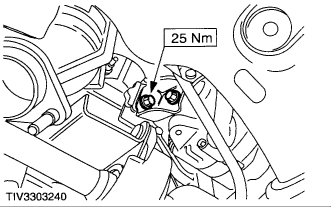

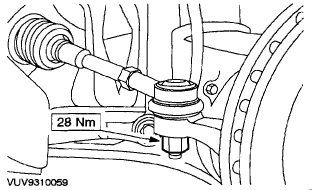

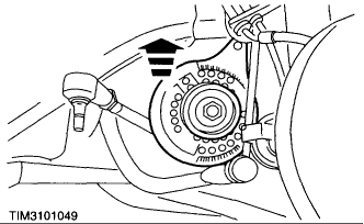

what's the easiest way to replace the alternator in my 99 mercury cougar?? its on the bottom left hand side of the engine. I cant get to it from the top, bottom or side

1. Disconnect the battery ground cable. 2. Remove the accessory drive belt.
https://images.2carpros.com/forum/automotive_pictures/248015_Alt_1_1.gif

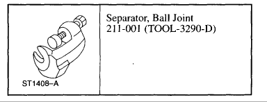

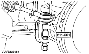

3. Separate the tie-rod end from the wheel knuckle using the special tool 211-001 (TOOL-3290-D). CAUTION: Protect the ball joint seal to prevent damage.

4. Disconnect the generator electrical connectors (generator shown removed for clarity).
https://images.2carpros.com/forum/automotive_pictures/248015_Alt_3_1.gif
5. Remove the generator rear support bracket bolt.
https://images.2carpros.com/forum/automotive_pictures/248015_Alt_4_1.gif
6. Remove the generator upper bolt.
https://images.2carpros.com/forum/automotive_pictures/248015_Alt_5_1.gif
7. Remove the generator lower bolt.
https://images.2carpros.com/forum/automotive_pictures/248015_Alt_6_1.gif

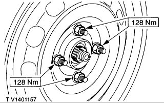

8. Remove the generator through the wheel opening.

INSTALLATION To install, reverse the removal procedure.
