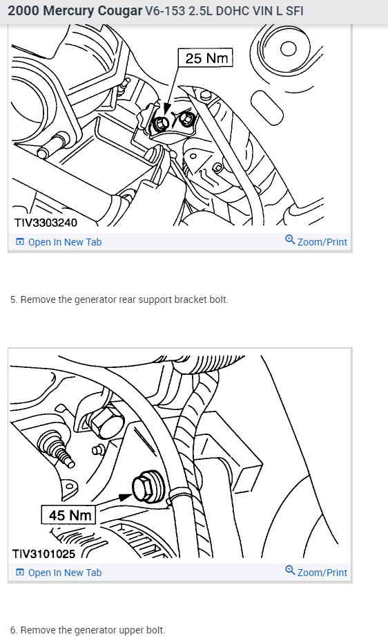

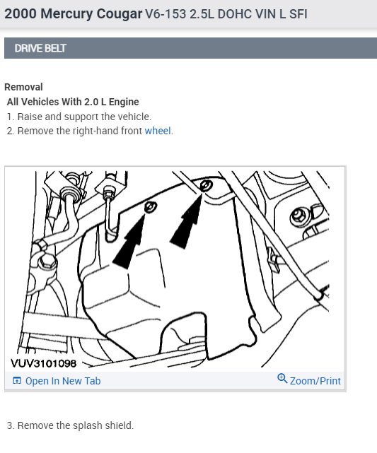

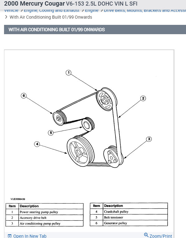

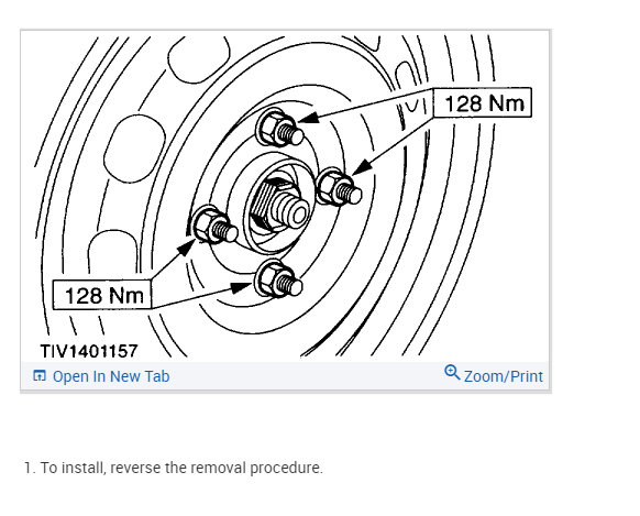

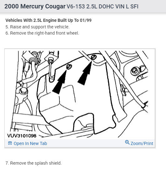

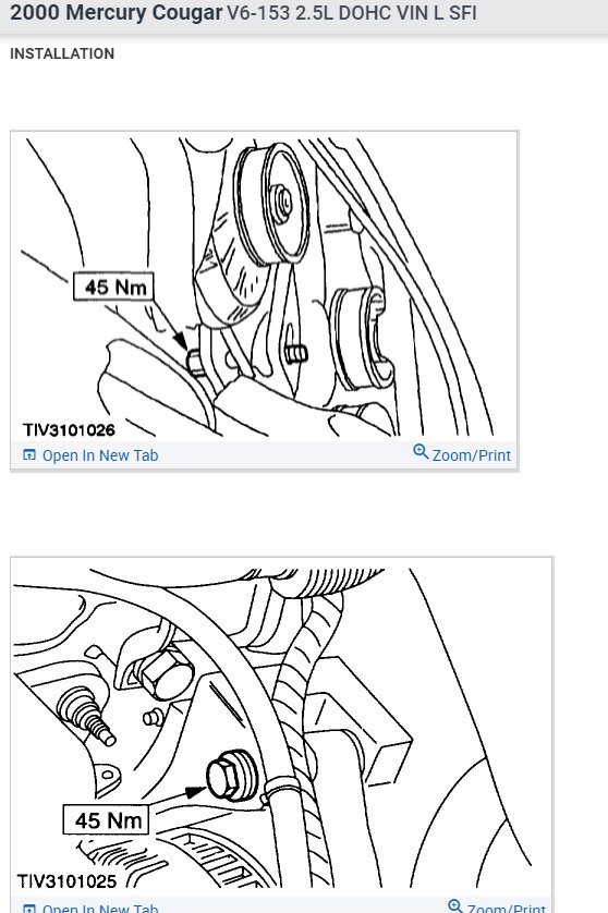

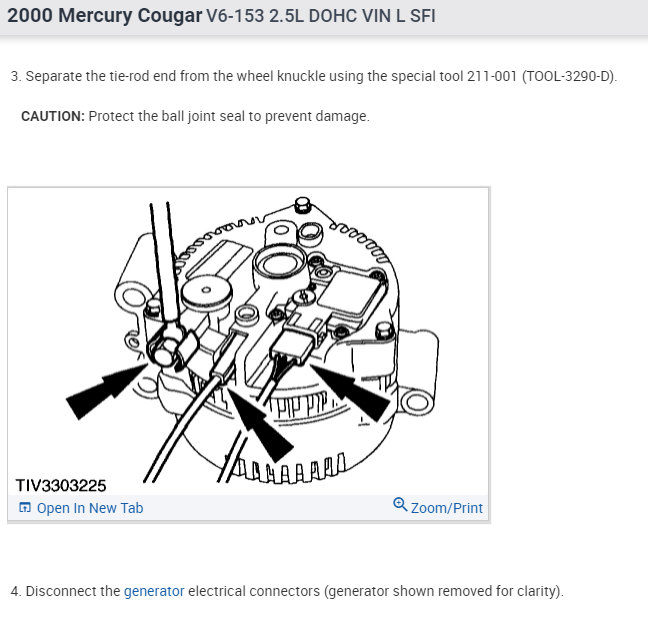

my alternator went out on my car, it looks hard to replace, how long is it estimated to get replaced at a shop? Whats the easiest way to get to all the bolts on the alt. ?
Feb 7, 2009 at 7:20 AM
SQM
  • 6,383 POSTS

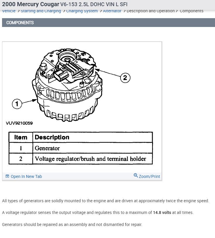

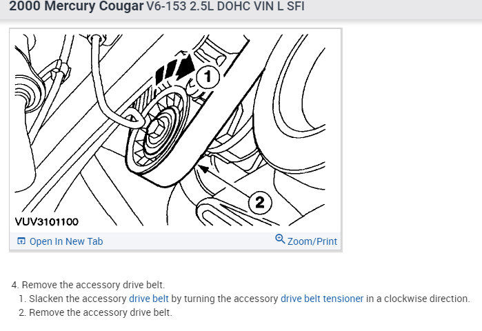

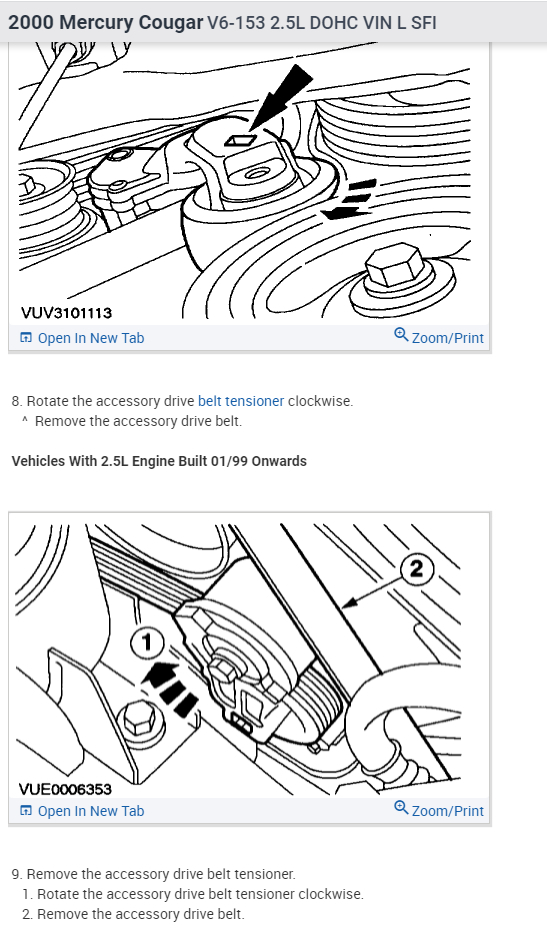

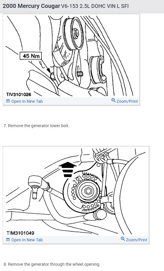

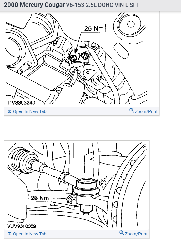

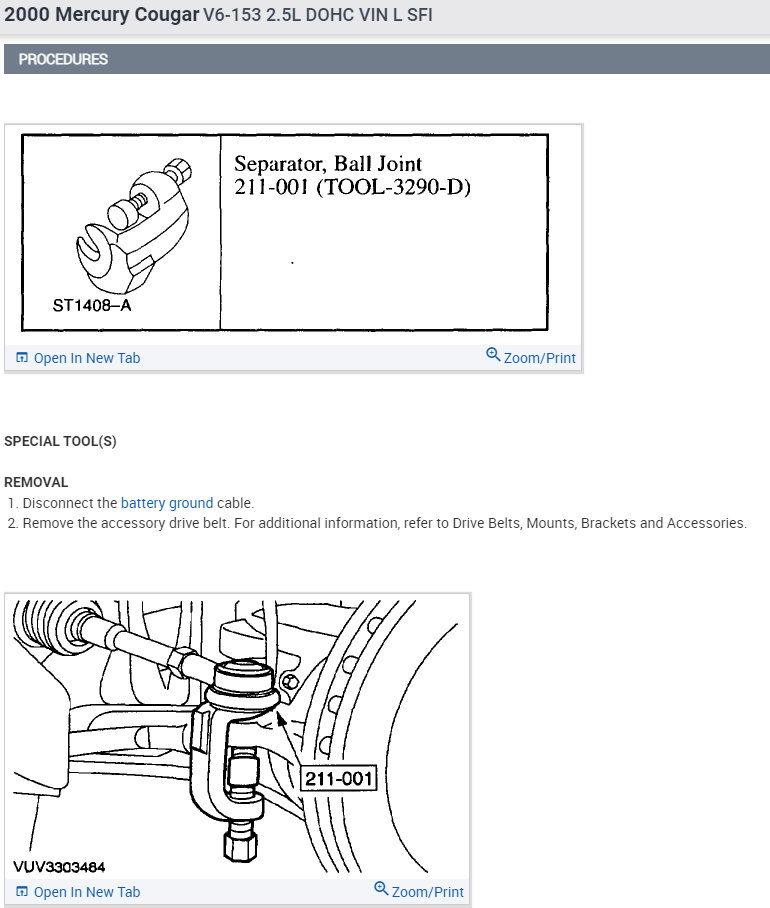

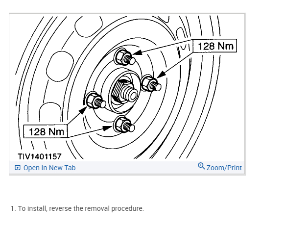

In order to replace the alternator, you will have to lift the vehicle and secure it with jack stands. Then take off the passenger side front wheel. And disconnect the tie rod end on that side. This will allow you to access the alternator.
I have attached the alternator replacement as well as the drive belt instructions below.
https://www.2carpros.com/articles/how-to-replace-an-alternator
