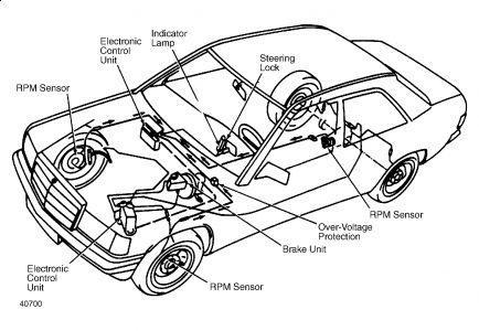

Hello .. thanks for the donation .. much appreciated Sounds like the solonoid valve for the rear brakes is not opening !! HYDRAULIC UNIT Independent of master cylinder pressure, hydraulic unit will compensate brake fluid pressure to wheel cylinders during regulation. Pressure increase above master cylinder pressure is not possible. The 3 hydraulic unit solenoid valves control left front, right front and rear brakes. By activating valves with current of varying amperage, brake fluid pressure in individual calipers may be increased, held or decreased. In pressure "build-up" stage, pressure increases by opening intake valve to pressure supplied by master cylinder. In pressure "holding" stage, which precedes "reduction" stage, pressure from hydraulic unit to wheels is constant. Output and input valves in solenoid valve are closed. During pressure "reduction" stage, brake fluid flows from reservoir to return pump. To maintain fluid volume, pump returns fluid to main cylinder against prevailing pressure. To dampen delivery noise, each circuit has a silencer. Relays for solenoid valves and return pump are on 12-pole socket of hydraulic unit. A diode is soldered in socket. Hydraulic unit is connected to ground by cable. Fig. 1: Mercedes-Benz Automatic Brake System Component Location
https://images.2carpros.com/forum/automotive_pictures/266999_merc_3.jpg
Hope this helps
https://images.2carpros.com/forum/automotive_pictures/266999_AAA2_369.png

Your answer indicated the solenoid valve for the rear brakes is not opening.
OK, I assume these Solenoid Valves are located in the ABS Hydraulic Unit mounted in the left fwd area of the Engine compartment (as identified in your diagram in this area as the Electronic Control Unit).
