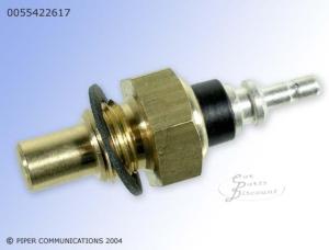

I looked on the underside of the intake manifold.
What I see is not the same as a picture of a coolant temperature sensor that I get on the internet. What I see are 2 electrical plugs plugged into a part mounted on the manaifold with vaccum lines attached. Is there a picture for me to look at?
If you can't provide a picture where can I look for one?
Apr 7, 2009 at 10:33 AM
BLUELIGHTNIN6
  • 16,542 POSTS
You may be looking at the MAP sensor...below is an example picture of what the sensor will look similar to
https://images.2carpros.com/forum/automotive_pictures/261618_1_33.jpg
Apr 7, 2009 at 10:47 AM
CAIRO
  • 13 POSTS
On the block toward the rear on the left side I find a part that is blueish in color with a wire plugged in. Your picture doesn't match any of the parts picture that I have pulled up. Could we be confusing diesel and gas engine parts?

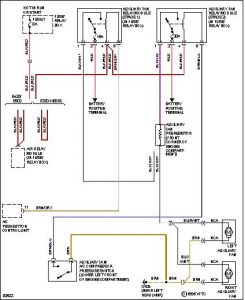

Sorry about that. I can not find a picture of the Diesel ECT sensor but I have dug up some wiring diagrams. First of all, I would like to bring to your attention that you have 2 relays for the auxilliary fan. Did you test both of these relays? Next, it appears the ECT sensor has a brown/yellow wire and a blue/yellow wire to it. Perhaps this will help you determine the correct sensor. Once you find the sensor, ohm it while the engine is at operating temperature. It should be reading 300 - 400 ohms. If it is higher or lower than sensor needs replaced.

Ok. Since these are both good you will now have to check the preresistor. It should be resisting currents to prevent the fans from running when not needed. If it is letting currents pass all the time then it has failed. A wiring diagram of the cooling fan circuitry is below to help you locate teh preresistor.

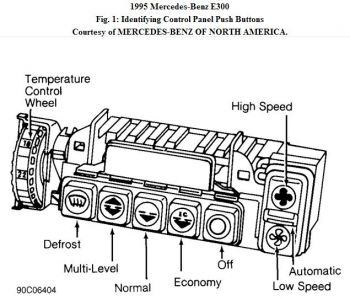

If the fan is working at low speed when ignition switch is turned ON, unplug the A/C push button control unit and see if it stops. If yes, the control unit is shorting to ground causing the fans to turn on.

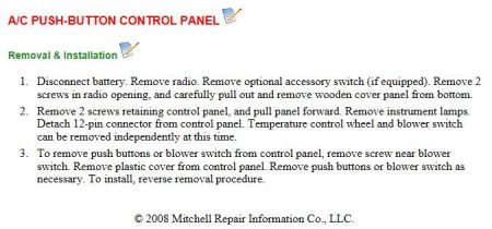

Removing the 30A relay stops the fan. Removing the 15A relay does not affect the fan. I have not located where to unplug the A/C push button control. Can you help me locate it?
Apr 20, 2009 at 10:28 AM
KHLOW2008
  • 41,812 POSTS

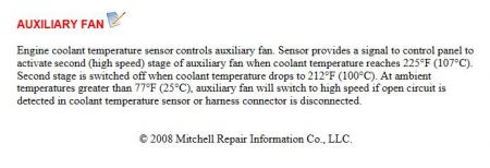

Removing 30A fuse means the auxiliary fans are working at high speed and the circuit should be controlled by the A/C compressor pressure switch. Test the Brown/Blue wire from relay to A/C pressure switch for shorting to ground. Unplug both relay and pressure switch to test. Here are a description of the Push Button and auxiliary fans.
