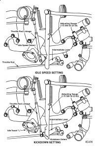

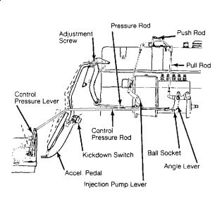

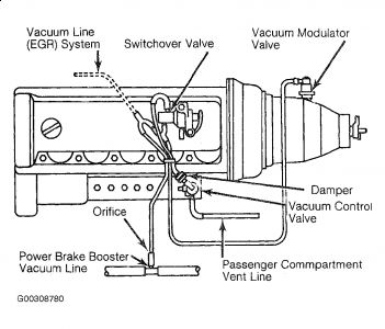

I have 1983 240D Mercedes . I changed the engine with 1981 and the transsmission is not shifting. Is there any possibility to fix it without changing the engine again with the right one?

I don't know where you got the engine, but the reason the transmission will not shift is because you need to adjust the kick down throttle cable located on the right-hand side. That is connected to your linkage. Because it is a newer transmission. It may be difficult to adapt it to the older style linkage from the throttle, also makes sure that you have the vacuum hooked up to the transmission.

OK you've made me do a lot of research, . I asked you if you had vacuum hook up to the transformation, you fail to respond only telling me " I t has only the linkage from the shifter to transmission and the speed cable" which is incorrect, For your benefit, I will explain to you, the vacuum control system to your transmission; VACUUM CONTROL SYSTEM Vacuum is tapped at vacuum line for power brake booster and is routed to switchover valve, a vacuum distributor, (by way of an orifice) to vacuum control valve and distributor. The switchover valve is actuated by a regulating system for shifting of 1st gear when moving off. Switchover valve is interconnected into vacuum control line from vacuum control unit. In idle throttle position, vacuum control valve connects vacuum line leading to vacuum control unit, while bypassing vacuum switchover valve. As a result, full pump vacuum of approx. 11 in. Hg. reacts on vacuum control and transmission stays in 2nd gear. During acceleration, switchover valve connects vacuum control unit with vacuum control valve. Depending on position of accelerator pedal, vacuum control valve establishes a vacuum value of approx. 0-6 in. Hg. This vacuum reduction is the signal to transmission to shift to 1st gear when moving off. California models also have a vacuum operated EGR (Exhaust Gas Recirculation) system with additional switchover valves. These switchover valves are also connected to vacuum control system, but they are only controlling EGR requirements. the following is a procedure to make sure the transmission has vacuum. VACUUM CONTROL SYSTEM Vacuum Control Valve Pull off vacuum line to transmission and connect vacuum tester (116 589 25 21 00) to "Y" connector. See Fig. 1 . Disconnect connecting rod at ball head. Start engine and increase speed to approximately 1300 RPM. See Fig. 2 . Place adjusting roller (916 589 00 21 00) on vacuum control valve. Raise lever on vacuum control valve until it contacts roller. Vacuum must read 11 to 17 in. Hg. If this value cannot be obtained, vacuum control valve must be replaced. Vacuum Switchover Valve With engine at idle, pull control line from switchover valve and connect vacuum tester. Run engine at idle. After about 1 minute, vacuum reading should be between 11-14 in. Hg. If vacuum reading is off, check to see if either suction or control line at switchover valve or vacuum control valve have been switched. Check for vacuum leaks (including central locking system, key start system etc.) Accelerate until switchover valve is actuated, vacuum should drop to 4-6 in. Hg. If not check orifice in distributor for being plugged or presence of a vacuum leak. If switchover valve is leaking replace unit.

it is also critical that your throttle linkage is adjusted properly, here's the procedure to ensure that; TRANSMISSION THROTTLE ROD Turn rotary knob of cable control for idling speed adjustment completely to the right. Disconnect throttle rod linkage, throttle rod, and accelerator rod from intermediate lever. Attach adjusting gauge with idle speed detent to intermediate lever. With throttle valve against idle speed stop, and throttle linkage pulled back, adjust throttle rod linkage length for a free fit on ball socket of intermediate lever. Push control lever to idle position, then adjust accelerator rod length for a free fit over ball socket on intermediate lever. See Fig. 1 . Fig. 1: 240D Throttle Rod Adjustment Remove adjusting gauge idle detent from intermediate lever. Press accelerator pedal to kick down position, adjusting gauge full-throttle detent should fit freely into intermediate lever. If not, adjust length of accelerator rod for a free fit. With adjustments made, check that travel "L", of throttle rod linkage, from full throttle position to kick down position is approximately .236" (6 mm). If not, adjust ball socket in oblong hole of intermediate lever. When adjustments are correct, remove adjusting gauge.
