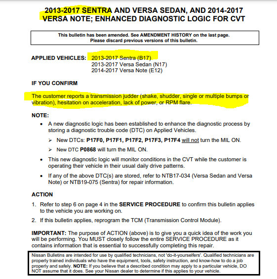

Mechanic code u3000 and u3400 said due to transmission. He thought either an update or replacement was needed. Said that was a Nissan code and he could not read it. But he did not see any problems with the components and did change the CVT oil today which was a little gunky. I took it in because I get a shuddering upon slightly heavy acceleration. It shuddered one time slightly after the fluid change. I drove it about 15 miles.

Here is what I'm going to suggest. Because of the complexity of this code, you should contact a dealership. The transmissions in these vehicles are continuous variable transmissions (CVT) and Nissan has indicated problems with the transmissions and transmission control modules. They will likely try to reprogram/flash the car's TCM.
When you contact a dealer, tell them you have been made aware of a potential recall specific to the shuddering. See pic below
Let me know if this helps or if I just caused more confusion. LOL I will tell you that CVT transmissions are usually replaced rather than repaired. They aren't as durable as a traditional transmission, so anything is possible.
See pic below.
