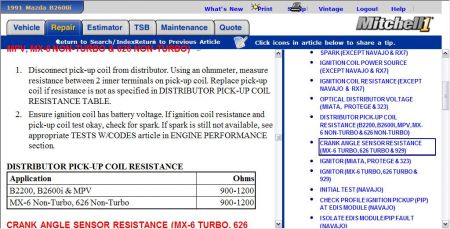

I have a 91 Mazda 2600 pickup with 46000 miles.. It died while driving, then started again and ran 15 minutes, died again and ran for a little while. Finally it could not start any more. I discovered I had no spark. I replaced the coil, wires, plugs, cap and rotor. and still I have no spark even at the coil. I don't see any fuses blown. I don,t mind replacing parts as labor costs are about $75.00 an hour, plus I would have to pay a hundred something to have it towed to nearest shop. Are there relays or hidden fuses? Something in the distributor maybe? Haynes manual does'nt seem to be very helpfull at troubleshooting.

Might want to test out the distributor pick-up coil see below
https://images.2carpros.com/forum/automotive_pictures/12900_1991_Mazda_B2600_pickup_1.jpg
