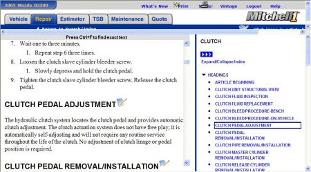

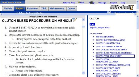

i have traced the lind and can not find the bleeder valve. i loose my clutch and i have to pump the clutch to get it back...Do i need a new slave cyl
Oct 18, 2008 at 8:36 AM
  • 75,992 POSTS
2003 Mazda Truck bleeding the hyd clutch
https://images.2carpros.com/forum/automotive_pictures/12900_cl1_1.jpg
https://images.2carpros.com/forum/automotive_pictures/12900_cl2_1.jpg
