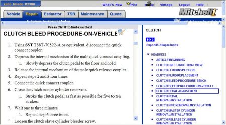

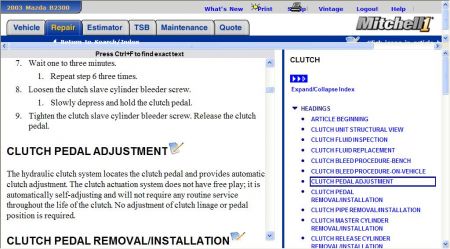

2003 Mazda Truck bleeding the hyd clutch
81,000 MILES • 4 CYL • 2WD • MANUAL
HOAREDOG
i have traced the lind and can not find the bleeder valve. i loose my clutch and i have to pump the clutch to get it back...Do i need a new slave cyl

https://images.2carpros.com/forum/automotive_pictures/12900_cl1_1.jpg
https://images.2carpros.com/forum/automotive_pictures/12900_cl2_1.jpg
