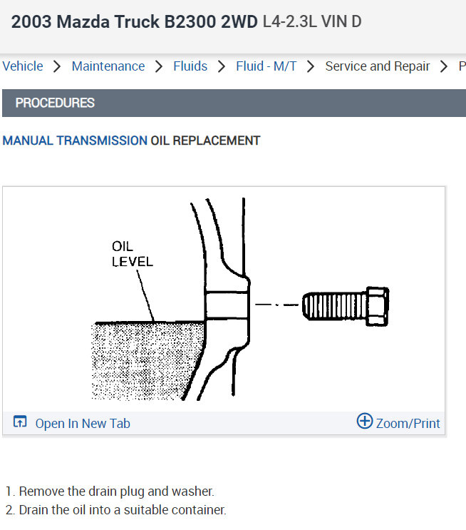

I cant find a manual transmission dipstick on my truck is there one?
2003 MAZDA TRUCK
B_BOY13
Transmission problem
2003 Mazda Truck V6 Two Wheel Drive Manual 70000 miles
I cant find a transmission dipstick on my truck is there one?
Dec 6, 2007 at 2:59 PM
MHPAUTOS
  • 31,937 POSTS
Hi there,
There is no dip stick on this manual transmission, Ask your service centre to check transmission oil levels for you.
Mark (mhpautos) :D
Dec 6, 2007 at 5:50 PM
  • 54,837 POSTS

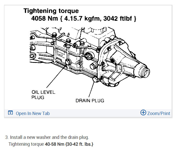

Or, or you can just do it yourself, here is a guid to show you how with images below to help you as well.
https://www.2carpros.com/articles/how-to-service-a-manual-transmission
Fluid Types
Specified oil grade .................... MERCON or M-111
Capacities
Capacity .................... 2.65 liters { 5.6 US pt. 4.5 Imp pt }
Check out the images (below). Let us know if you need anything else.
