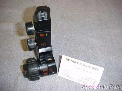

I have checked fuse and the fuse is good , the head lights work, but i have no tail ights no side marker lights and no illuminatrion lights in side car ( dash ) can anyone give me a suggestion on where to check next thank you

[/quote:e988b0fb00] my problem was the main harness that plugs into the main light switch. head light wouild still work as did brake light but no tail light dash light no parking lights. i had to replace the harness plug and the left side cluster switch(head light parking tail etc. i blieve my switch is different than yours mine is years
https://images.2carpros.com/forum/automotive_pictures/95681_headlight_1.jpg
86-91
