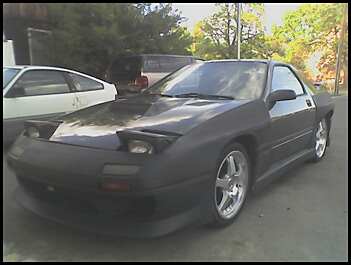

This is my 1986 Rx7, as you can see it is being modified.
At this point in time i have ran into a stick in the mud.
The problem is I have no running lights, I have replaced the fuses all of em. also changed all the bulbs too inside and outside bulbs. But still no fix yet.
I have brake light and turn signals, also hazard lights work too.
So what am I missing, I have thought that is could be a bad switch but am hoping that i am wrong.
Anyone have this problem before?

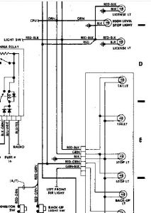

Hello !! I think that your problem its a single wire... follow it all the way to the switch it could be bad at some point ( RED AND BLACK WIRE ) Also check the BLACK wire (ground) you can check the switch, if good should show output on the red and black wire positive (+) Here the wire schematic:
https://images.2carpros.com/forum/automotive_pictures/576_Mazda_RX7_1.jpg

Thanks i thought it might be that cause i also forgot to say that i have all my dash lights too. But i will see if i can find this evil wire in that small area Again Thanks for your help.
