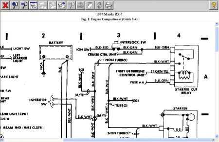

Our 1986 RX-7 has problems starting sometimes. The engine has no known mechanical problems and once started, it performs just great and we can stop and turn the engine off and it will start agin with ease the next day. However, there are times when we can not start the engine the next day. The battery has been replaced. When we attempt to start the car, nothing happens and the engine does not even turn. We also replaced the ignition assembly and cables that are directly behind the key on the steering column. But this did not seem to help. Are there any known problems with Mazda 1986 RX7 of these nature?
Thanks for your help.
Don in Iowa
May 11, 2008 at 5:01 AM
  • 75,988 POSTS

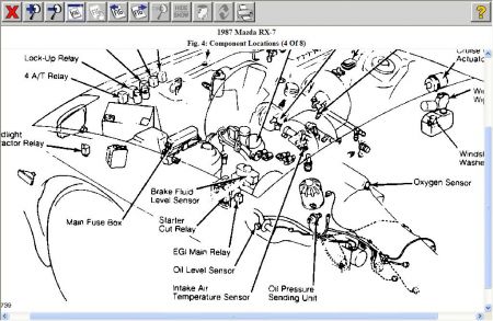

Jumper the clutch switch at the clutch pedal bracket and attempt to start. also check the fuse no.6 and starter cut relay-See below

here this is probable a simple problem it happens with every generation 2 rx 7 atleast once. lift the hood take out the 40 amp fuse labled "eng inj" try starting the car a few times and put the fuse back. it should fire right up. you may need to do it a couple times..
