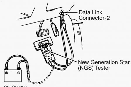

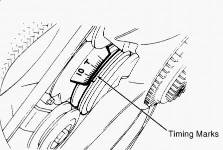

MERLIN2021
  • 17,250 POSTS
MIATA & PROTEGE 1.6L Loosen CKP sensor bolt. Using feeler gauge, adjust air gap between sensor and crankshaft sensor plate projections to .020-0.59" (0.5-1.5 mm). See Fig. 10 . Tighten CKP sensor bolt. If clearance is still not within specification, replace CKP sensor or sensor plate behind crankshaft pulley. Fig. 10: Identifying Crankshaft Position Sensor Air Gap Courtesy of MAZDA MOTORS CORP. IGNITION TIMING B2300, B2500, B3000, B4000 & TRIBUTE Engine is equipped with an electronic distributorless ignition system. Base (initial) timing is preset and is not adjustable. Inspection of timing is done through World Diagnostic System (WDS) scan tool or equivalent. Information is not available for this procedure from manufacturer. MIATA, MILLENIA, MPV & PROTEGE 1. Connect NGS scan tool to DLC-2 located under left side of instrument panel, right of steering column. See Fig. 12 . Connect a jumper wire between terminals TEN and GND at DLC-1 in engine compartment. See Fig. 13 . 2. Ensure idle speed is correct. See IDLE SPEED under IDLE SPEED & MIXTURE. On all models except Millenia 2.3L, connect timing light to high-tension lead No. 1. On Millenia 2.3L, connect Inductive Timing Light (49-T018-002) lead to ignition timing checking harness (Black/White wire) located next to engine compartment relay box. See Fig. 11 . Start engine and allow it to idle. Check timing. See IGNITION TIMING SPECIFICATIONS table. See Fig. 14 . Fig. 11: Identifying Ignition Timing Checking Harness NOTE: Before adjusting or inspecting ignition timing, warm engine to normal operating temperature. Turn off all accessories. Place transmission in Neutral (M/T) or Park (A/T). Wait for cooling fan to stop. Ensure idle speed is correct. See IDLE SPEED under IDLE SPEED & MIXTURE. NOTE: New Generation Star (NGS) scan tool is used to perform following procedures. NOTE: On Millenia 2.3L, ignition timing is not adjustable. NOTE: Standard inductive timing light may not work on ignition timing checking harness. Recommend using manufacturers Inductive Timing Light (49-T018-002) or equivalent. 3. On all models except Millenia 2.5L, if ignition timing is not within specification, check CMP sensor, CKP sensor, TP sensor, ECT sensor and transmission range switch. See appropriate SYSTEM & COMPONENT TESTING article. If all sensors and switches are okay, replace PCM. 4. On Millenia 2.5L, if ignition timing is not within specification, loosen distributor lock bolt. Rotate distributor until timing marks align. Tighten lock bolt. Recheck timing. 626 1. Connect NGS scan tool to DLC-2 located under left side of instrument panel, left of steering column. See Fig. 12 . Ensure idle speed is correct. See IDLE SPEED & MIXTURE . 2. Connect timing light to high-tension lead No. 1 and check timing. See Fig. 14 . See IGNITION TIMING SPECIFICATIONS table. If ignition timing is not within specification, check CMP sensor, CKP sensor, TP sensor, ECT sensor, neutral switch, clutch switch and transmission range switch. See SYSTEM & COMPONENT TESTING - MIATA, MILLENIA, MPV, PROTEGE & 626 article. If all sensors and switches are okay, replace PCM.
https://images.2carpros.com/forum/automotive_pictures/62217_gap_1.jpg
https://images.2carpros.com/forum/automotive_pictures/62217_dlc_1.jpg
https://images.2carpros.com/forum/automotive_pictures/62217_ten_1.jpg
https://images.2carpros.com/forum/automotive_pictures/62217_marks_2.jpg
