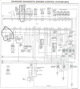

I have owned my 2000 Mazda for about 18 months and shortly after buying it the check engine light came on. Long story short, I had both converters replaced, both O2 sensors, new spark plugs, and new coil pack. It was only after the new coil pack did the problem get solved - or so I thought. A few months ago the CEL came back on. I was told that one of the 02 sensors had failed (b/c I went with a cheap brand) and it was replaced with a Bosch. This did not solve the problem and the CEL would come on for a few days and off for a few days. The CEL has been on non-stop over the last couple weeks. Up until today, the car drove great. However, the idling became rough today and actually stalled out twice while waiting at a stop light. The car (when not idling) drives very nice. I have spent enough money on this car already and am at my breaking point!

WROBLEWSKI1991
P0171 and P1569. Thanks.
Monday, October 19th, 2009 AT 9:24 PM
MATHIASO
  • 1,209 POSTS
Thank you for coming back with codes.
I was good at guessing for the mass air flow sensor :-)
P0171 is your mass air flow sensor.
Remove it and clean it with brake fluid or electronic cleaner , sometime it does the triks.
There could be a vacuum leak downstream of the MAF sensor, or the sensor is just faulty .
if the fuel filter have never been changed, it time to do it.
P1569 , this is a variable tumble control system solenoid valve.it is between the egr valve and egr boost sensor solenoid valve. it may be faulty.
there is also a variable tumble control system vacuum switch. check the ground at the switch and check the switch.
I have send the diagram in your email and it should be clear there.
