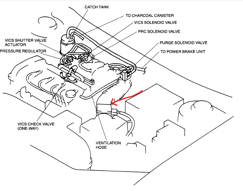

how do i change the mass air flow sensor on my 1999 mazda protege

If it is a 1.6L motor it only requires a philips screw driver. If it is a 1.8 or 2.0L engine. you will need only a 10 mm socket

The mass air flow sensor is at the air filter housing here is the location. Check out the images (Below). Please let us know if you need anything else to get the problem fixed.
