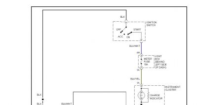

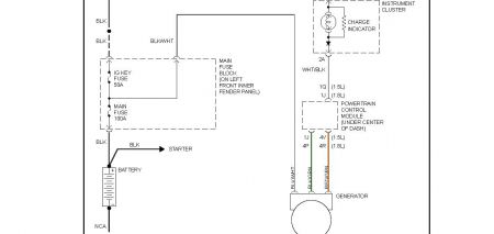

SIGIFREDO1986
i bought this car at auction and found when i got home the check engine light was not working.someone had removed the check engine lamp and of course when i put it in it was on.i scanned and found a few issues.all the sensor pids are displaying full voltage(5 volts).and also the pcm is reading 18 volt charging voltage.with a voltmeter i only have 11 volts at the battery.i am assuming it is the computer itself.i would like some more info on this issue before i replace the pcm
Jul 24, 2020 at 11:33 AM (Merged)
  • 75,988 POSTS
Could be the PCM controlled of the alternator field generation-See below
https://images.2carpros.com/forum/automotive_pictures/12900_a1_10.jpg
https://images.2carpros.com/forum/automotive_pictures/12900_a2_9.jpg
