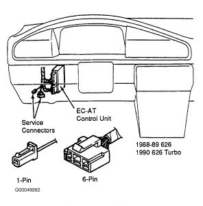

About my Hold light problem.
The hold light flashes on and off.
There is no problem with normal shifting. It's just that the hold feature does not work. I don't use this feature anyway.
Is there any real concern? I can live with the light flashing on and off. As I said, the car drives fine.
Rod
Dec 16, 2008 at 3:25 AM
RACEFAN966
  • 5,029 POSTS
Ok that may have something to do the EC-AT module. So if you have a digital multi meter and can make a jumper wire then we can first pull codes from it and then do some diagnostics. So first you need to make a jumper wire and ground the single pin connector and turn on the key and count the flashes of the hold light as it will flash in numerical sequence the code numbers to you. Lets say it gives a code 11 it will flash 1 short pause and flash 1 then longer pause and on to the next number ok. Get the codes to me and we will go from there. Here is where the connector is and what it looks like.
https://images.2carpros.com/forum/automotive_pictures/249564_Graphic_18.jpg
