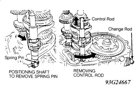

Driving home when suddenly it seems like I lost the shift pattern.. clutch is engaging and disengaging properly, it's just hard to find forward gears and almost impossible to find reverse......

Most likely fault in crank lever roll pin may have come out. It is internal. But first make sure shift linkage is solid.

Shifter has several inches of vertical movement... going through the pattern without the engine running each gear shifter has a pattern, but it seems that there is a pivot point (like a horizontal rod) that the shifter rides on that broke.
I'll have to call around tomorrow and see if any shop can offer a solution... my Chilton manual is useless... I'd have it apart if I didn't live in an apartment.

Update... after the static test I decided to take a test drive around the block... my first theory that a "horizontal rod or pivot point" broke was strengthened by the fact that as long as I pulled up on the shifter when changing gears there was no trouble. Reverse is still a bear to find.. but maybe this additional info might help.

Good that seems to rule out internal trans problem. Unable to find diagram of shifter. So will need to do visual inspection pull shift boot off see if that reviles problem. The shifter is a rod that attaches to trans shift control that is where shift gate is controled. hope diagram will help
https://images.2carpros.com/forum/automotive_pictures/198357_Graphic_177.jpg
