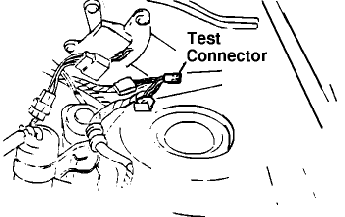

My engine trouble light on my 91 Mazda MPV stays on. How do I get the codes and determine the problem and how do I clear the light?

Hello, Here is how to retrieve codes..... 1.Warm engine to operating temperature and turn ignition "OFF." 2.Ground the test connector (1 pin wire) with a jumper wire. NOTE: Test connector is located next to the check connector in the engine compartment near the left side strut tower. 3.Turn the ignition switch to the ON position. 4.If MIL illuminates, goes off, and stays off no codes are present. 5.If MIL illuminates, goes off, and then starts flashing, codes are present. 6.Count the flashes to determine the fault code.
https://images.2carpros.com/forum/automotive_pictures/188069_91mazda_test_conn_1.gif
Here are some Mazda Codes 1 Ignition Pulse. 8 Air Flow Meter. 9 Water Thermo Sensor. 10 Intake Air Thermo Sensor (Air Flow Meter). 12 Throttle Sensor. 14 Atmospheric Pressure Sensor. 15 Oxygen Sensor. 17 Feedback System. 25 Solenoid Valve (PRC). 26 Solenoid Valve (Purge Control) . 28 Solenoid Valve (EGR). 34 Idle Speed Control Valve (ISC). .
