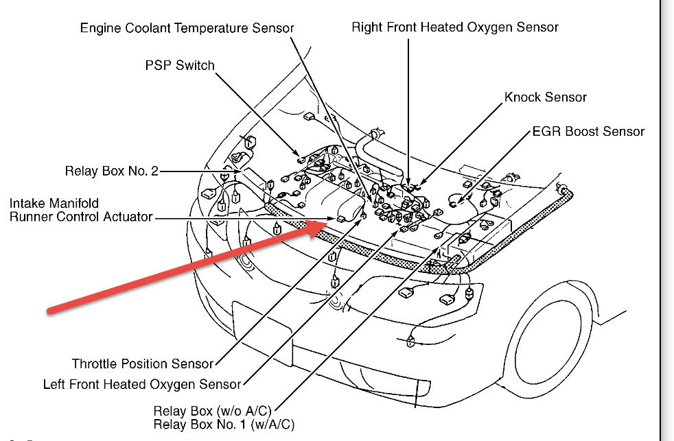

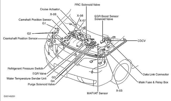

code 1496-99 deal with EGR valve shorted. so it is probably in need of a new one. the 152 is intake manifold runner control check for a bad connection, shorted wire , or actuator. it can also be the PCM which a mechanic should check. there is no 606 code.

the 152 is a typo error so same answer for that. i forgot to send picture on last reply. these may be tied together with the 106 code which in these pictures show cause on which to check. like loose connections, vacuum leaks etc or sensor bad. PCM is located behind glove box on floor passenger side.
