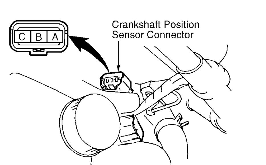

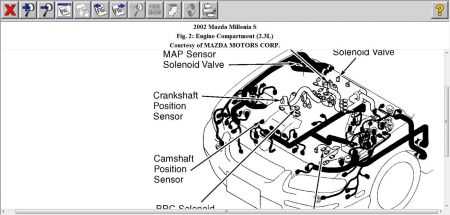

Car will not start, I know I know, but
2002 MAZDA MILLENIA
EROGEL334
Electrical problem 6 cyl Automatic
Long story short.... we have spark up until the coil, trust me I felt it. However the spark plugs are not receiving spark. The wires are fine, the spark plugs, rotor, and distributor cap are brand new. My mechanic and I are lost as to what do next.
The car's timing was just fixed as it was off. The crank sensor is fine since we're receiving spark up until the coil.
Its definitely not a fuel problem. We here the fuel pump go off, we smell it, we definitely have compression, we tested for it. The ignition system is fine since it cranks, for some reason however there is no spark at the spark plugs, but there's spark at the coils. The distributor cap, rotor, and spark plugs are new, the spark plug wires are fine. We are stumped as to what to do next.
I would appreciate any advice or help.
Thanks for reading.
Oct 23, 2010 at 2:50 PM
  • 75,992 POSTS
Inspect and test the crankshaft position sensor on front of engine
https://images.2carpros.com/forum/automotive_pictures/12900_cps_53.jpg
Oct 25, 2010 at 2:58 PM
EROGEL334
i dont mean to be difficult, i appreciate your help... however... if the problem were the crankshaft position sensor... would we still receive spark at the coil?
Oct 25, 2010 at 4:01 PM
  • 75,992 POSTS
for some reason however there is no spark at the spark plugs, but there's spark at the coils. this one is kind of hard to understand either you have it or don't-check and test both the Cam and Crank sensors-
Inspect for shavings on the sensors
Check the CPS resistances should read 950-1250 ohms, also the wiring for shorts and open
Camshaft Position Sensor (Millenia 2.3L)
Camshaft Position (CMP) sensor is located on right front of engine. Disconnect CMP sensor harness connector. Check for continuity between CMP sensor connector terminals "B" (Red/Black wire) and "C" (Yellow/Black wire). If continuity is present, replace CMP sensor. If continuity is not present, check for short or open circuit between following:
CMP sensor 4-pin harness connector terminal "B" and main relay 4-pin harness connector terminal "D" (Red/Black wire).
CMP sensor 4-pin harness connector terminal "C" and PCM 34-pin harness connector terminal "4F" (Yellow/Black wire).
CMP sensor 4-pin harness connector terminal "A" and PCM 34-pin harness connector terminal "4D" (Black/Blue wire).
Repair open or short circuit in wiring harness as necessary.

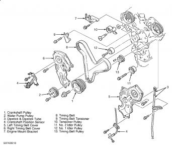

WALDEN
  • 7 POSTS
Engine Mechanical problem
1996 Mazda Millenia 6 cyl Front Wheel Drive Automatic
my car gets spark turns over but wont start it has low compression
Dec 15, 2016 at 10:47 AM (Merged)
DOCFIXIT
  • 18,828 POSTS
What are readings?
WALDEN
  • 7 POSTS
it has about 70 compression
DOCFIXIT
  • 18,828 POSTS
Not enough to pop it's rebuild time are all cylinders the same? if yes tear it down
WALDEN
  • 7 POSTS
well it jumped timing could that be a problem
DOCFIXIT
  • 18,828 POSTS
You mean belt broke?
WALDEN
  • 7 POSTS
no it jumped timing it was my brothers car n he had some 1 put a new belt on it n it aint lined up meaning the arrows
WALDEN
  • 7 POSTS
what will i have to do if i have 2 rebuild it

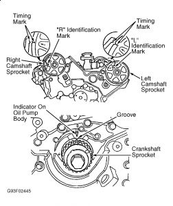

KIKI88
The battery reads 12.8 volts. Has fuel pressure and spark, it tries to crank but nothing happens after that. The guy I bought it from pulled the auto start box(the brain) out and I'm not sure if that will stop if from starting. As to the fuel pressure, the tester reads 38 when starting but not when you turn the key to the on position. The check engine light is not on and there are no codes saved. any help would be appreciated. Thank you!
DOCFIXIT
  • 18,828 POSTS
Pull front covers off and check
https://images.2carpros.com/forum/automotive_pictures/198357_Grafic_3_106.jpg
https://images.2carpros.com/forum/automotive_pictures/198357_Graphic_398.jpg
  • 110,244 POSTS
If you have spark and the proper amount of fuel pressure, it should run unless it is out of time, or there is low compression.

WALDEN
  • 7 POSTS
im going to donate 20dollars to u guys for yr help but i have 1 more question can that be the problem why my car aint starting and if all the cylinders aint bad do i have to rebuild
KIKI88
Ok thank you. Any ideas as to why there is no fuel pressure when the key is turned to the on/ run Position?
DOCFIXIT
  • 18,828 POSTS
If belt is off couple teeth that would lower compression. One cylinder low would indicate a valve all low and even readings makes me think Timing is issue. All cylinders low usually does not happen sometime if ran really hot rings will go, so if that didn't happen timing good place to start.

WALDEN
  • 7 POSTS
does the arrorw have to be lined up the same way
