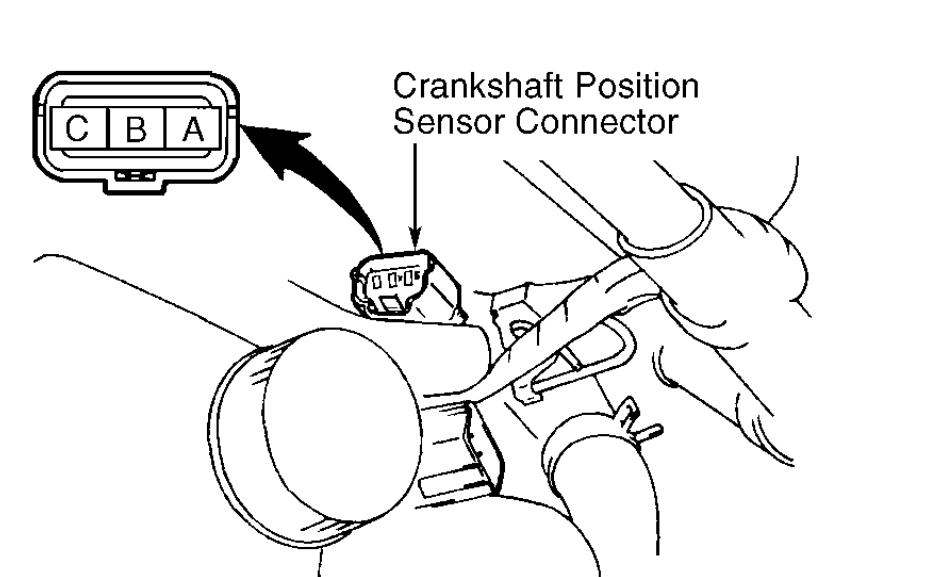

Long story short.... we have spark up until the coil, trust me I felt it. However the spark plugs are not receiving spark. The wires are fine, the spark plugs, rotor, and distributor cap are brand new. My mechanic and I are lost as to what do next.
The car's timing was just fixed as it was off. The crank sensor is fine since we're receiving spark up until the coil.
Its definitely not a fuel problem. We here the fuel pump go off, we smell it, we definitely have compression, we tested for it. The ignition system is fine since it cranks, for some reason however there is no spark at the spark plugs, but there's spark at the coils. The distributor cap, rotor, and spark plugs are new, the spark plug wires are fine. We are stumped as to what to do next.
I would appreciate any advice or help.

Inspect and test the crankshaft position sensor on front of engine

i dont mean to be difficult, i appreciate your help... however... if the problem were the crankshaft position sensor... would we still receive spark at the coil?
Oct 25, 2010 at 11:01 PM
  • 75,992 POSTS
for some reason however there is no spark at the spark plugs, but there's spark at the coils. this one is kind of hard to understand either you have it or don't-check and test both the Cam and Crank sensors-
Inspect for shavings on the sensors
Check the CPS resistances should read 950-1250 ohms, also the wiring for shorts and open
Camshaft Position Sensor (Millenia 2.3L)
Camshaft Position (CMP) sensor is located on right front of engine. Disconnect CMP sensor harness connector. Check for continuity between CMP sensor connector terminals "B" (Red/Black wire) and "C" (Yellow/Black wire). If continuity is present, replace CMP sensor. If continuity is not present, check for short or open circuit between following:
CMP sensor 4-pin harness connector terminal "B" and main relay 4-pin harness connector terminal "D" (Red/Black wire).
CMP sensor 4-pin harness connector terminal "C" and PCM 34-pin harness connector terminal "4F" (Yellow/Black wire).
CMP sensor 4-pin harness connector terminal "A" and PCM 34-pin harness connector terminal "4D" (Black/Blue wire).
Repair open or short circuit in wiring harness as necessary.

hey hook it up under hood if it works fine if not you haven' lost anything. try wiggling the crank sensor connector then see if it fires if it does the connector isn't any good. che resistance of crank and cam sensor here is crank sensor,........
Millenia 2.3L950-1250
Millenia 2.5o & 626 (3) 520-580
measure between A & B

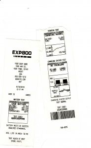

Electrical problem
1996 Mazda Millenia 4 cyl Front Wheel Drive Automatic 127000 miles
Have owned this car since October and ever since owning it, it periodically does not start. No particular pattern. Sometimes goes over a week without a problem and then sometimes will have won't start a couple times in one day. When we took it in to get looked at, the car never seems to not start. The battery works fine and the engine turns over well, even when it is not starting. When it does not start it seems like it is not getting a spark. Generally if enough time passes it will start again.
Here is the strange part. My son by chance jumped the car even though it was turning over fine and it started right up. We have done this now so many times we no that it is not just happen chance. Why would this be, and does this give us some insight into what is going on.
ONe other thing - the car was clearly in an accident and was hit on the drivers front side. Not sure if this has anything to do with problem

Have you tried a different battery? Sometimes if the starter draws too much power from the battery, the cars computer cant work properly.Have the battery and starter draw tested to see where they are at.Also check to be sure all connections are clean and tight

We did the battery and starter draw test. See attached report from that test. Guy at Checkers said it looked all good. The car continues to start most of the time. And the care continues to turn over well - but still from time to time won't start. Every single time when it is not starting (but still turning over) if we jump it with another car it will immediately start. one last thing - when it was not starting we checked to see if there was a spark by pulling the plug wire and it turns out that there was no spark. Any ideas

Still sounds like a low voltage situation.All you are gaining from the other battery is more stable voltage.Check every connection related to the power and ground cables and check for any corrosion in the fuses under the hood and under the dash.

The ground cable going to the engine block has one 2 inch section that is very frayed. Could this be the issue. Also, is it possible that the battery, although having good power, is the cause of not having stable voltage. Should we try and replace the battery based on all we know now? Thanks

Thr ground cable doesnmt necessarily need to be fuly insulated, as long as it isnt frayed, causling loss of contact it should be ok, no corrosion either.Id hate to say buy a battery and have it not work, can you swap a known good one in there from another car to test it?
