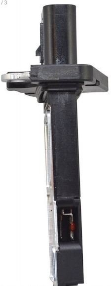

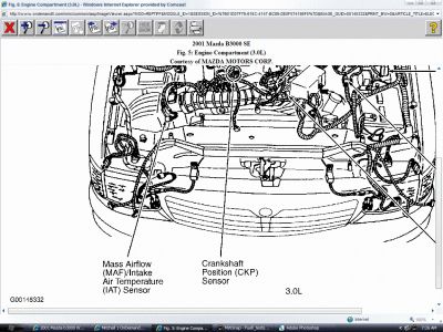

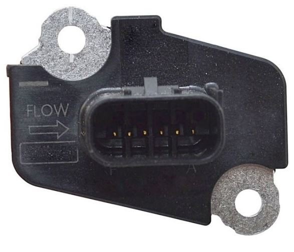

Where is the Air Intake Sensor on 2001 B3000? I'm not quite sure where it is, and I've been looking for a good half hour. I don't know where everything is, so please don't use technical terms. One person told me that it was the little thing with 2 wires sticking out. I don't know what that is... please be specific and simple.

On yours it's a Mass airflow and IAT all in one unit, and it's at the air filter box.

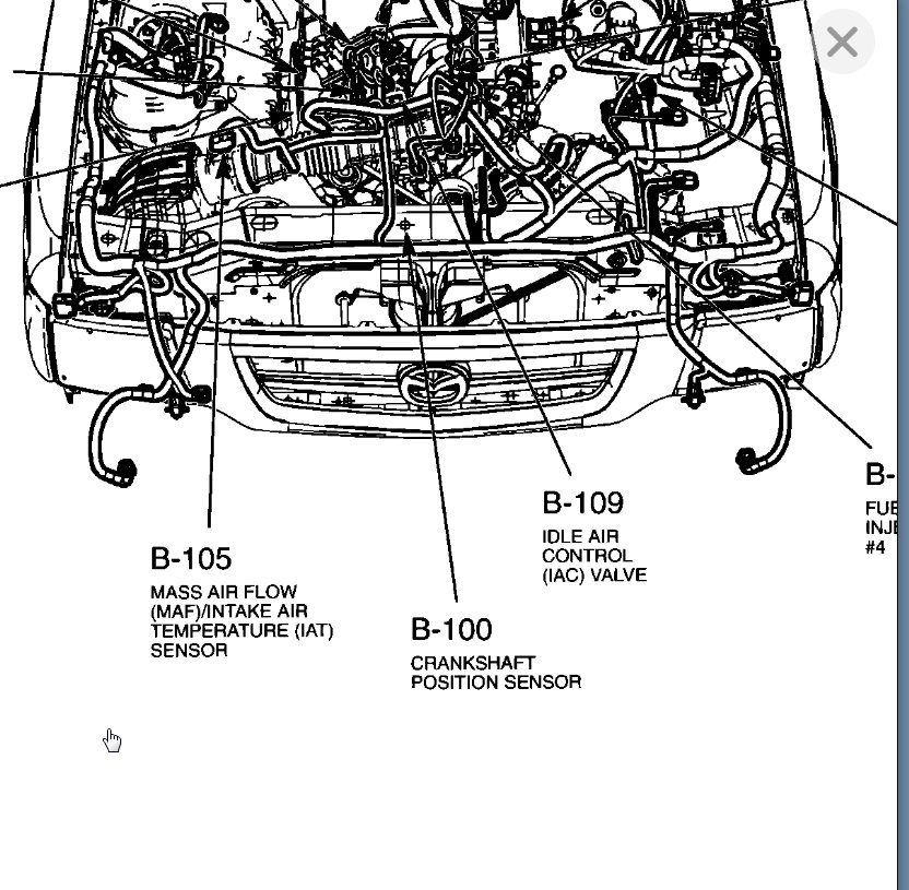

is this the same on a 2004 mazda b3000, 3.0
Jan 16, 2020 at 5:31 PM
STEVE W.
  • 15,200 POSTS

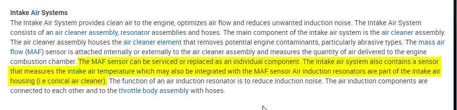

Yes, the MAF and intake air sensor are a combined unit located in the air cleaner housing.
Jan 16, 2020 at 6:08 PM
Yes. That is correct. Please see attached for you truck.
