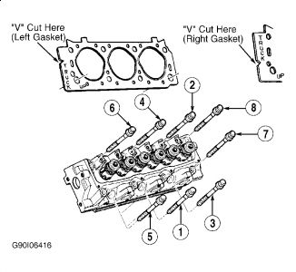

What should the torque be on the rocker arms and head bolts?

Hi there, Head bolts torque... Step 1, 80 N.m step 2, loosen 1 full turn, step 3, 45-54 N.m step 4, 85-99 N.m Rocker arm bolts. step 1 10-12 N.m step 2 27-38 N.m

Do you feel that there is an actual need to replace the head bolts with new once they have been pulled?

Hi there,
I always replace the head bolts, with set torque bolts you can get away with using old, torque to yield must be replaced, but for piece of mind i always replace them regardless.
