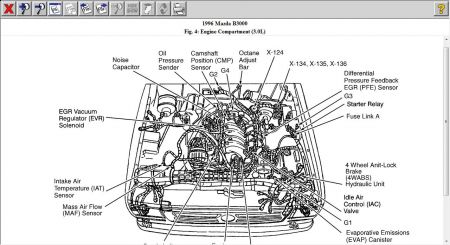

I need to change my "Oil Pressure Sender" but have had no luck locating it. Please help.

Its on right rear of engine
https://images.2carpros.com/forum/automotive_pictures/12900_ops_1.jpg
