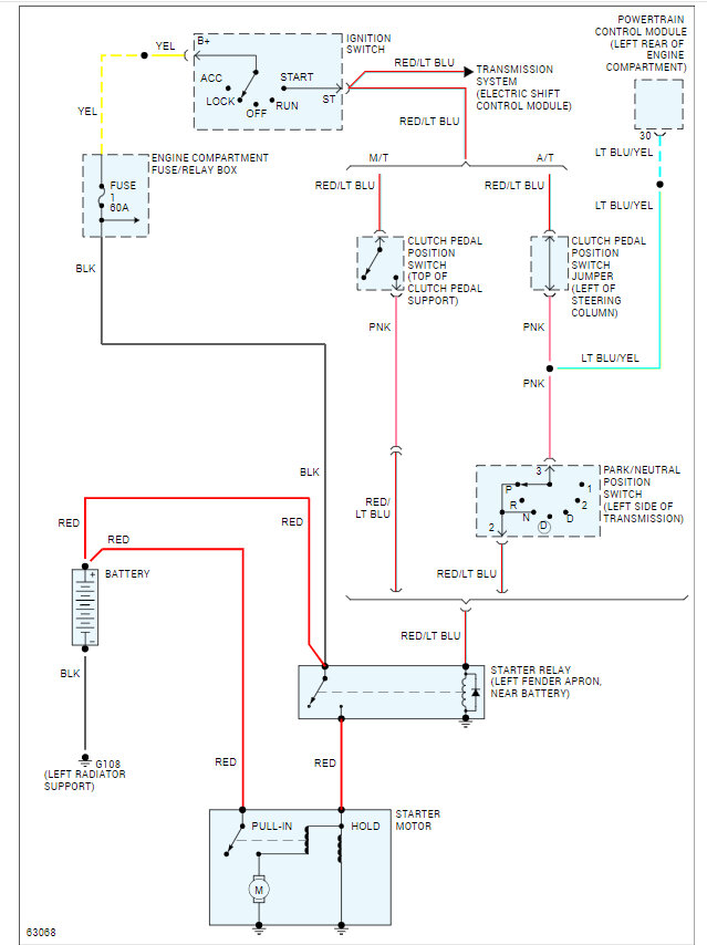

Will not turn over. New battery, new starter, new solenoid, new battery cables, voltage transfer. What else do I need to check or replace? However, I can push it and it will start. Any suggestions?

Check and test the clutch switch, starter relay and ignition switch

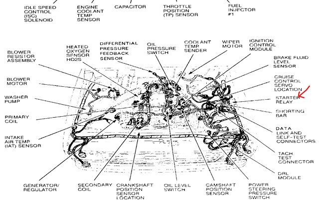

Where is the starter relay? Is that the solenoid?

Starter relay is on the left fender apron near the battery.

Here is the starter relay location and the wiring diagrams to the relay to make sure you got the right one, also, I would go over this video as well.
https://youtu.be/6YRW8fyNudY?si=qTnNNNpI9DSTvQT6
check out the images (below). Let us know what you find.
