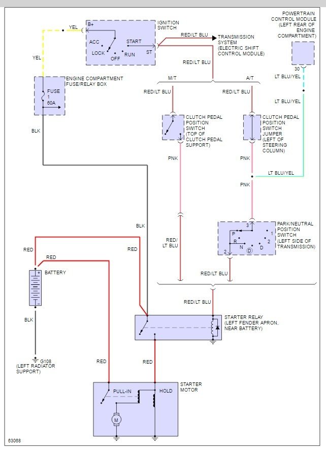

Need wiring diagram for Starter Solenoid.

It looks like there is a relay that runs the starter as well, here is a guide and a wiring diagram to help you fin the problem.
Run some tests and get back to us so we can continue helping you.
