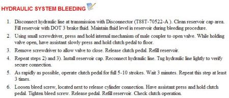

Yes my truck has had trouble shifting gears, and i pretty much have no pedal. I figured that we needed to bleed the clutch to get air that was built up in the line out. i got to the bleed valve in the slave cylinder, loosened the valve but no fluid came out as it was supposed to. my main question is do i need to have the clutch in when i loosen the bleed valve for the fluid to drain?

https://images.2carpros.com/forum/automotive_pictures/261618_Noname_1505.jpg
